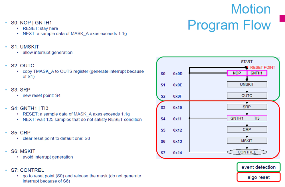

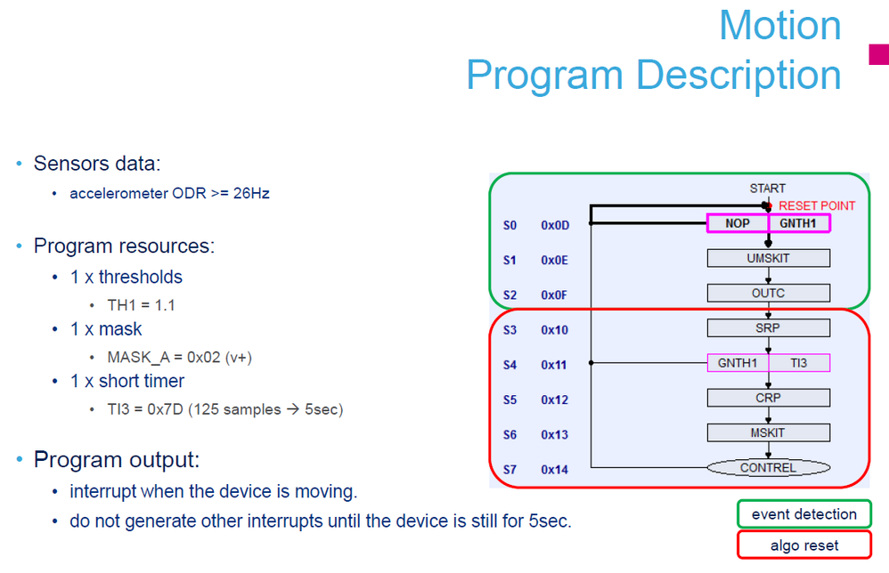

Can I use motion/station event with fsm to detect moving of a car ?
https://github.com/STMicroelectronics/STMems_Standard_C_drivers/blob/master/lsm6dso_STdC/example/lsm6dso_fsm.c
In this link can I use (lsm6so_prg_motion) values to detect motion ?
I believe so: this is a generic flow for motion detection.
You might have to fine-tune the threshold and the timings for taking into account a car motion instead of a person motion, but should work.
Here below I share you some more details on this FSM algorithm:
-Eleon
