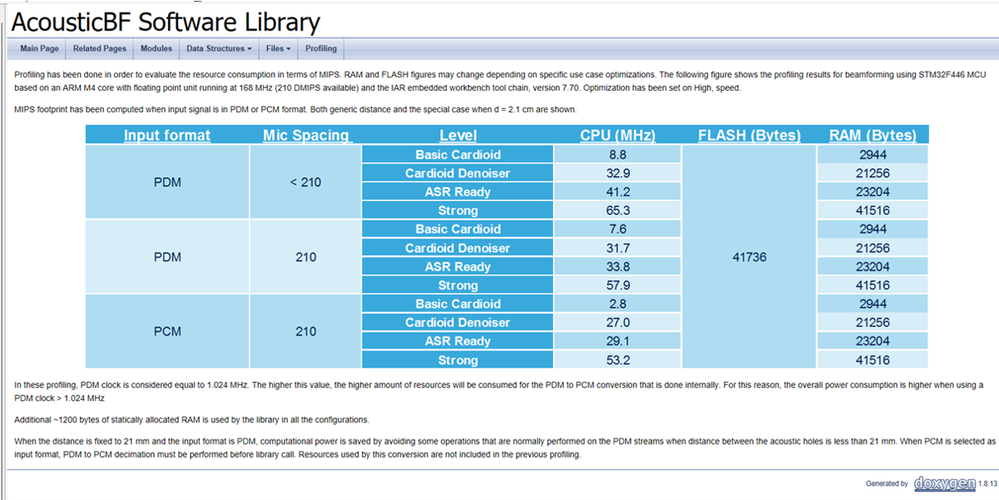

    I played a little bit with beamforming lib setup. In PCM mode I can use only 21mm distance. And in PDM mode the max. usable distance is 40mm, else the init function returns an ACOUSTIC_BF_DISTANCE_ERROR. So now I think, the STs beamforming library is not usable for bigger distances than 40mm. Am I right?
    Eleon BORLINI
    February 5, 2021
    Hi @Király Béla​ ,
    the maximum allowed distance is 21.2mm (so the maximum value allowed in the mic_distance variable is 212).
    Our experts confirm me that this is also the optimal measure for which ST library has been calibrated.
    For a more reasoned choice between PDM and PCM, you can refer to the table below:
    If you control PDM clock, you have to pass also that parameter to the library
    Otherwise, it would be better to use ST PDM2PCM library and run the BF in PCM mode.
    -Eleon
