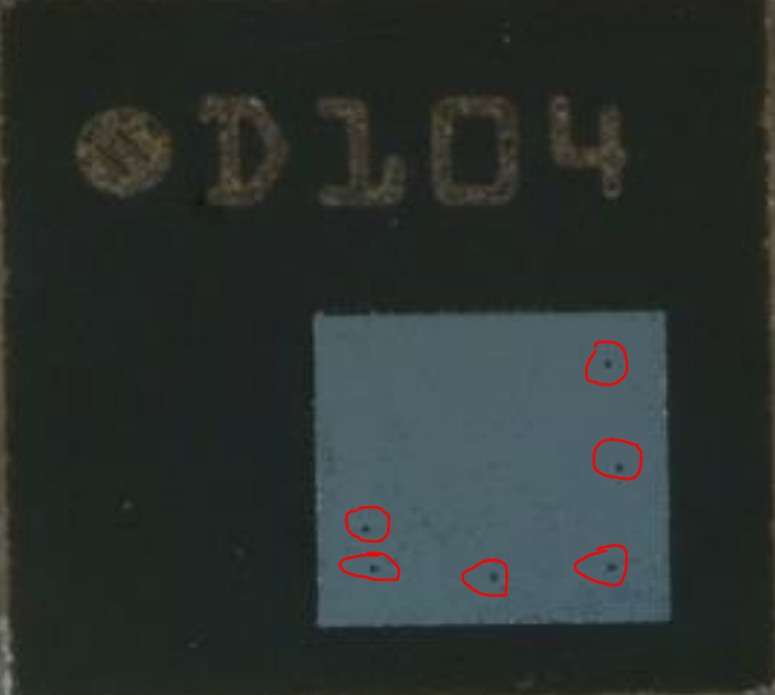

In the LPS22HB datasheet , there is a statement " The package is holed to allow external pressure to reach the sensing element." Is there a hole somewhere in the part package that should not be covered up, and should be kept clear of obstructions?

Usually if the hole is not done on the plastic package, it is very small on the silicon exposed cap area of the package. Pressure doesn't need a "big" hole. Humidity sensors do as humidity is like a cloud, needs movement... a fan ideally.

@S.Ma​  is right, you can have a look to this picture

Thanks for the information. These are extremely small diameter holes barely seen under my microscope. So I assume the MEMs diaphragm is somewhere in the cavity below the "silver foil" cover with the 6 holes? ( I originally maybe wrongly assumed that the silver foil was not holed and was the diaphragm that flexed with changes in the atmosphere pressure).

correct (the silver foil is actually a silicon cap)
