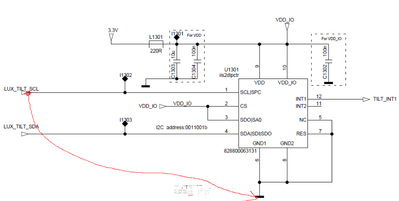

For special test case, that directed connected IIC's SCL(LUX_TILT_SCL) to GND and kept for 5mins, will this action hurt or damage IIS2DLPC?
IIC worked with 100kbps.
Work with IIC.

Grounding SDA or SCL will not hurt the chips, but it will prevent communication from taking place. SDA/SCL are driven with open drain, so pulling them down doesn't cause hardware issues.

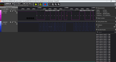

Use a logic analyzer to see what's happening on the line.
BBBBBB
With logic analyzer, after 5mins ground SCL, the chip randomly cannot response with IIC even remove SCL grounding.
No response could not recover even cold reboot the chip.

I wound like to confirm whether these 5min SCL grounding cause IIC slave(sensor) stuck?
