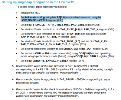

From the datasheet, my understanding is that tap detection requires FS to be set to ±2 g, although I may be mistaken. This requirement also seems to be indicated in another document, DT0101 Design Tip: Setting up single-tap and double-tap recognition with ST’s MEMS accelerometers.
Although this document describes the procedure for a different accelerometer, I assume the same requirement might also apply to the IIS2DLPC.
In short, I would like to confirm whether it is possible to configure FS to a value other than ±2 g while still being able to use the tap detection feature.

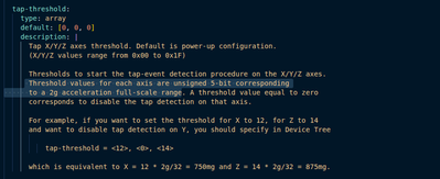

I have also found this in the zephyer binding file of iis2dlpc.
Could you please confirm whether tap detection can be used with the full-scale (FS) set to a value other than ±2 g?
Thanks!
