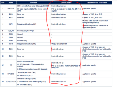

Hi @niccolò ,
Thank you for the information.
In our design , vibration sensor(IIS3DWBTR)  interface with STM32L562 controller using SPI interface. We are checking the current at sleep mode but getting the current is more(0.28mA) instead of 5-16uA.
Can you please let us know ,Pin status of Vibration sensor in sleep mode?
In the above image, on reset default state of the pins we understood ,we want to know what is the pin status in power down mode?
Hi @nandhinis ,
When the device is in power down, the state of the pins is controlled just by electrical connections and the microcontroller. are you afraid the lines are consuming power because you made some bad connections?
can I ask you one question? are you able to read the WHO AM I register of the sensor?
Niccolò
