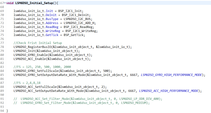

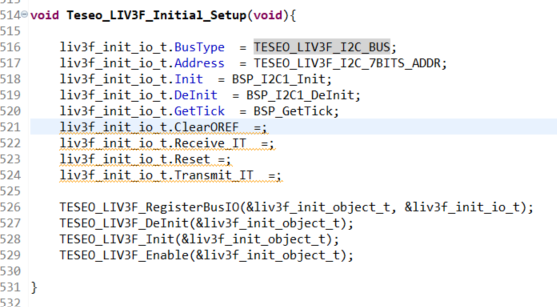

Im trying to use LIV3F with F303RE board. I have trouble to configure the LIV3F. Can it be setup like LSM6DSO for example? Here is how I did this:0693W00000LylAmQAJ.png0693W00000LylC8QAJ.pngCan the same method be applied to LIV3F? If so, what is ClearOREF, Receive_IT, Reset and Transmit_IT?0693W00000LylChQAJ.png
