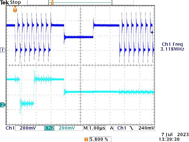

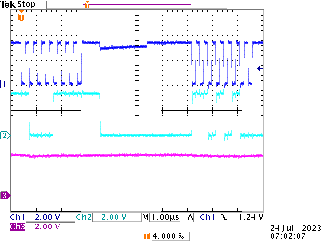

As can be seen from the following scope trace 0x0C is written to 0x12.
But when the 'Who Am I' register (0x0F) is read back 0x00 is received.
From the above I'm assuming that the CTRL3_C (0x12) command is not being received by the ISM330DLC as the SPI clock is not being pulled high as per the datasheet.

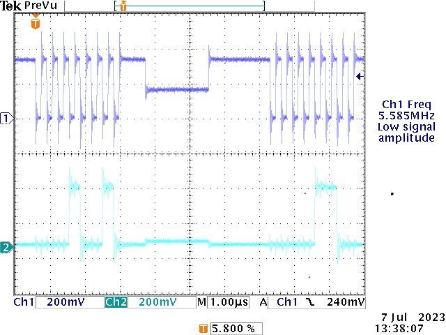

Find below the CS / Clock trace from the 'Who Am I' (0x0F) register read operation.

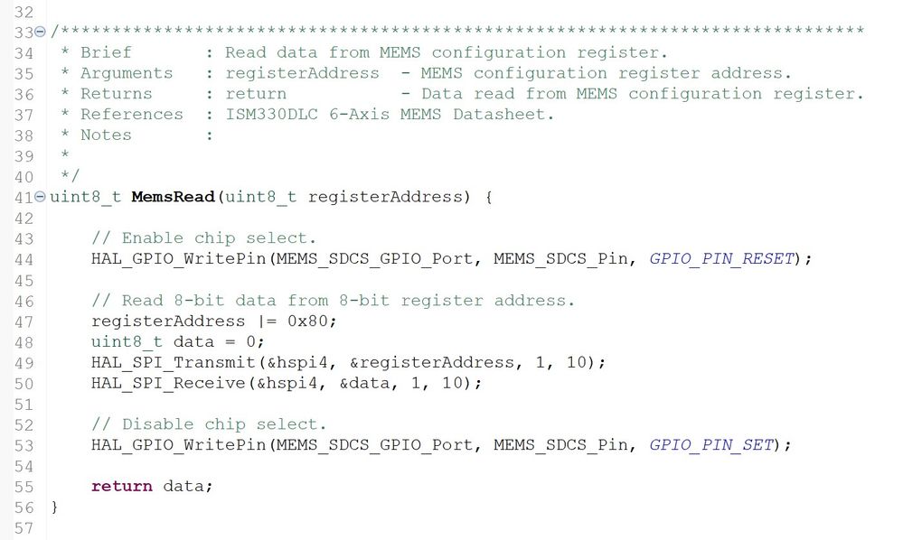

My SPI Register Read code is below which has no additional operations between the write and read function.

Hi @GnR ,
the CS is ok, the thing I imagine is that the sensor did not received the command to go in 3wire SPI, so it is sending the response on SDA, instead of SDO. (if you could check with the oscilloscope that pin we can try to confirm that the sensor is alive)
then, another issue that I can think of is the power to the sensor, so could you double check it? how much is Vdd?
I would check that before replacing the sensor, but just to answer your question, on the microcontroller side, I really don't see any issue with the communication =)

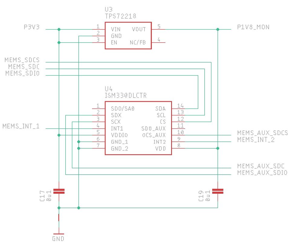

I removed the chip and confirmed that the PCB layout compared to the following schematic.
A brand new chip was then fitted but the results were exactly the same as before i.e. no response from the chip.
My end goal is to run the chip in Mode 4 but at this moment in time the MEMS_AUX lines are open circuit.
Regards

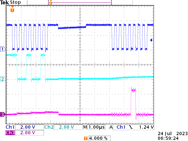

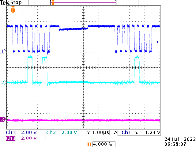

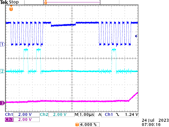

I managed to access to the SDO pin and i have made some progress.
Set register 0x12 to 0x08 to enable SPI 3-wire mode.
Then read register 0x12 and observed contents (0x08) on SDO.
ISM330DLC did not entre SPI 3-wire mode.
Experimented and discovered that if register 0x12 was set to 0x10 that SPI 3-wire mode was enabled.
Read register 0x12 and observed 0x10 on SDA, SPI 3-wire mode enabled. TEK00003.BMP
Question, is this a datasheet error or have I misinterpreted something?
Read register 0x0f (Who Am I) and observed 0xD4 on SDA.
Was expecting 0x6A as per datasheet, if 0x6A is shifted 1 bit left you get 0xD4.
The reading of registers must be correct as when 0x12 is read it is correct (see above) assuming datasheet error.
