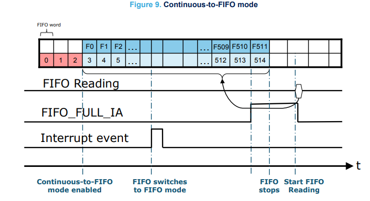

Eleon BORLINI
Hi @DLafo.1​ ,
I see you are configuring the "Continuous Mode", which is however not so suggested for working with interrupts.
You should use Continuous-to-FIFO mode for managing the FIFO interrupt.
0693W00000NrdMYQAZ.pngPlease have a look to the AN5444 application note, from p. 32.
-Eleon
