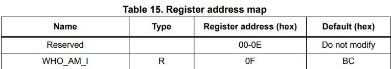

Hi all, I have been trying to read any data from HTS221 on extension board, and HAL I2C functions returns error.
I try to read WHO_AM_I register but HAL_I2C_Memread function always returns timeout so error. Any suggestion would be appreciated, thanks.
The simplest code to read WHO_AM_I register below

Hi @Eleon BORLINI​ i found the problem, i2c bus was broken on my nucleo i tried different board and it runs successfully.
Thanks for interest.

Hi @oziesin​ ,
are you facing the issue only with the humidity sensor, or also on the other sensors?
And is your project based on this firmware basis I-CUBE-LRWAN - LoRaWAN software expansion for STM32Cube (UM2073) - STMicroelectronics?
-Eleon
