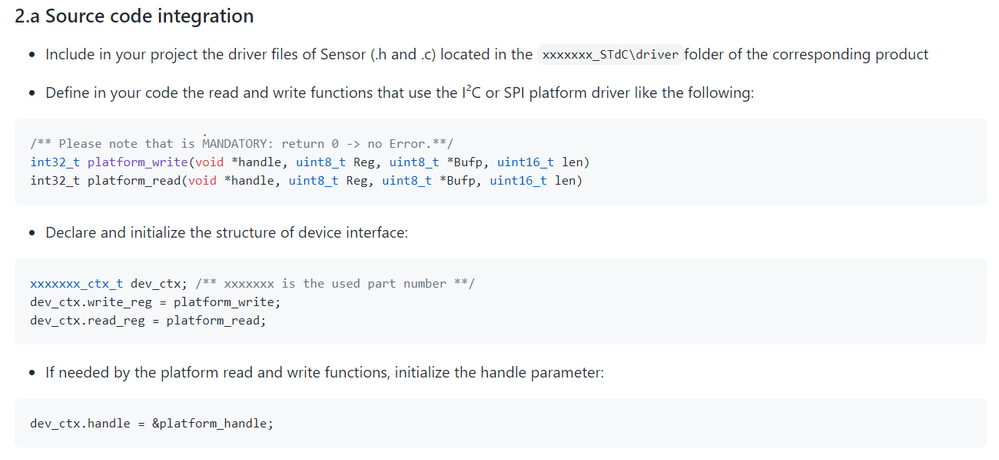

I am interfacing this lsm9ds1 MEMS sensor with the STM32F429zit6 nucleo board. LSM9DS1 IS NOT Responding I am using ST lsm9ds1 drivers on github using data polling code sensor is not responding, anyone tell me where the problem occures?

Hi @PRAMU.1​ ,
In order to integrate the, you can refer to the dedicated section in the readme file of Github homepage, at the paragraph:
0693W00000Bd5pGQAR.pngDid you already try this procedure?
-Eleon

Hello Mr Borlini, if I use custom board of STM32L083, can I use these LSM9DS1 .c & .h file driver?
-Anuar
Hi Anuar @ABin .1​ ,
yes you can, you have just to take care of the specific platform in terms of the pin configuration and the proper peripheral (e.g SPI) initialization.
