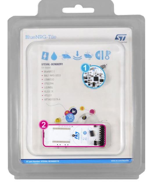

I've just bought a STEVAL-BCN002V1B (BlueNRG - Tile), with the host board to Flash and debug, and i would like to know how i can easily program it.

If you want to create your own firmware and upload it on the Bluecoin, please note that the STEVAL-BCN002V1B device kit contains the STEVAL-BCN002V1D programming board (the N.2 in the first picture you shared): the usual way to program the sensor board (the STEVAL-BCN002V1 one, N.1, the Bluetile) is to connect the JTAG/SWD for Nucleo ST-LINK of the STEVAL-BCN002V1D to an STLINK (V2 or V3) and to the PC and follow the standard indication using for example the STM32 CubeProgrammer free IDE. You can also directly connect the STLINK-V3 to the Sensor module (STEVAL-BCN002V1), as described in the Databrief, p.2. This standard procedure is described for example HERE.
There is another way to program the Bluetile (without additional hardware such as the STLINK V3 module), it is called UART Bootloader and this is described in this presentation, p. 62: you can simply download the .bin file (i.e. the executable file) on the uC of the Bluetile using the BlueNRG-1_2 Flasher Utility, described here.
