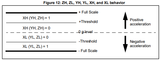

please note that the threshold crossing event recognition works in the following mode: you can define a threshold, for example 200mg, and this threshold is the same one both for the negative and for the positive sides of the full scale. You can decide if this threshold has to be crossed from low to high (XHIE. YHIE, ZHIE bits of INTx_CFG registers) or from high to low (XLIE. YLIE, ZLIE of INTx_CFG registers). An event will be generated accordingly to these cress-treshold direction events.
What you could do for your purpose is use the 6D orientation detection (that can be enabled through the AOI and 6D bits of the INTx_CFG register), as described in the application note AN5005 at p.28:
When configured for 6D function, the ZH, ZL, YH, YL, XH, and XL bits of INTx_SRC give information about the value of the acceleration generating the interrupt when it is greater than the threshold, and about its sign. In more detail:
• ZH (YH, XH) is 1 when the sensed acceleration is bigger than the threshold in the positive direction
• ZL (YL, XL) is 1 when the sensed acceleration is bigger than the threshold in the negative direction.
0693W000005A32PQAS.pngSo, in your specific case, you can set the INT1_THS (32h) at 200mg and enable the XHIE (or the YHIE or ZHIE depending on the axis along which you want to detect the peak) of the INT1_CFG (30h) register.

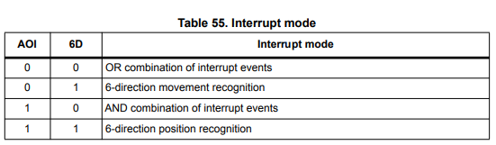

Hi @AB.4​ ,
But are you receiving some kind of interrupt signal?
Setting the INT1_CFG - 0x70, you may not enable the OR condition on the Z axis.
Can you try with 0x30? In this way you will enable only the "OR combination of interrupt events" function:
0693W000005AJyUQAW.pngYou may also try to reduce the INT1_DURATION - 0x02 to 0x01...

I set INT1_CFG to 0x70 because I want to enable 6D orientation detection as per your suggestion to detect positive and negative peaks as attached in the previous screenshot. I tested by setting to 0x30 and it generates the interrupt but there is no way to know if it's positive or negative peak since the absolute value of threshold is considered. Is there a way to get around this?
