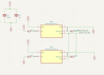

2024-08-27 8:55 AM
Hi, I am facing issue to interface STM32F446RE custom board with MP34DT05-A. This is the attached image of my schematics for mics.
I am using very simple code just to read the mics data and convert the PCM signals into dB levels.

I am using modified code from ST Discovery board example where the audio data is storing in buffer and playback using USB port.
Any help is highly appreciable. I am attaching received data file for your review. Any support is appreciable.
