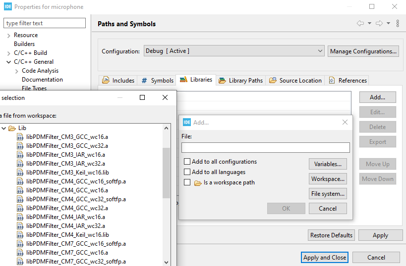

I struggle to use PDM Filter library.
This is the message error I get :

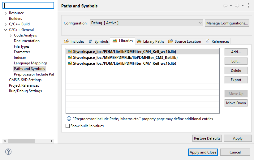

0693W00000KbhBQQAZ.pngWhat I have done so far are : - in project properties, C/C++ general, Paths and syombols, in "Includes" I added the path to pdm2pcm_glo.h ; in "Library Paths" I added the path to a folder with all the libPDM_FIlter_CM3_GCC_wc16.A ... files.- Wrote #include "pdm2pcm_glo.h" in the main.
It's still not working :\
In "Paths and Symbols", in libraries, I think I can add a library but I don't know which one to use (all the files were included in mems1 folder). I tried randomly picking but I had another error message;
0693W00000KbhEyQAJ.pngI am new to cubeIDE so it's very possible Im doing a beginner mistake here
Thanks for you answer. I managed to fix the issue, it was a mistake with how I confugired the C/C++ Build settings. Thanks for taking your time to help me !

I'm using STM32CubeIde 1.8.0 and for the library I took one from memsmic1_v5.6.0.
Maybe I'm doing something wrong with the library because when I do this :
I get this message error :
c:\st\stm32cubeide_1.8.0\stm32cubeide\plugins\com.st.stm32cube.ide.mcu.externaltools.gnu-tools-for-stm32.9-2020-q2-update.win32_2.0.0.202105311346\tools\arm-none-eabi\bin\ld.exe: cannot find -lC:/Users/username/STM32CubeIDE/workspace_1.8.0/MEMS/PDM/Lib/libPDMFilter_CM4_Keil_wc16.lib

The error message suggests that there is no problem with include of header files. Pre-processing seem to work. The error is finding the PDM_Filter_Init function in the linked arhive file.
Did you have a look at the CubeIDE User Guide and specifically the chapter 2.5.8 Include libraries?
It shows quite hands-on how to add a library. I think you could validate this first.
Which library is the right one? Not sure... There seem to be dedicated archives for GCC, choose the one matching your fpu setting.

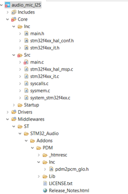

The "pdm2pcm_glo.h" file is part of PDM2PCM library. You have to download the full zipped STM32CubeWB package from ST.com and then extract the content of the library Middlewares/ST/STM32_Audio.

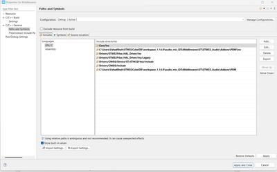

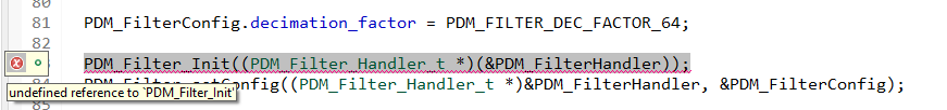

Hi, I am trying to use the pdm2pcm code to get the audio from MEMS I2S interface mics SPH0645LM4H.
I am getting this error during build.
Description Resource Path Location Type
C:/Users/mylaptop/STM32CubeIDE/workspace_1.14.0/audio_mic_I2S/Debug/../Middlewares/ST/STM32_Audio/Addons/PDM/Inc/pdm2pcm_glo.c:31: undefined reference to `PDM_Filter_setConfig' audio_mic_I2S C/C++ Problem

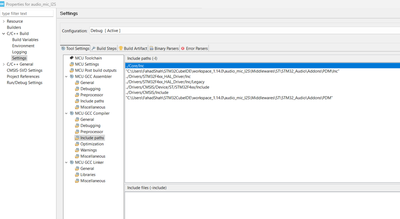

Hello @FShah.1
I suggest you in: C/C++ General/ Include paths and Symbols to Edit the format :  Middlewares/ST/STM32_Audio/Addons/PDM/Inc and Middlewares/ST/STM32_Audio/Addons/PDM
And in C/C++ Build / Settings / MCU GCC Compiler / Include Paths :    ../Middlewares/ST/STM32_Audio/Addons/PDM/Inc  and  ../Middlewares/ST/STM32_Audio/Addons/PDM
