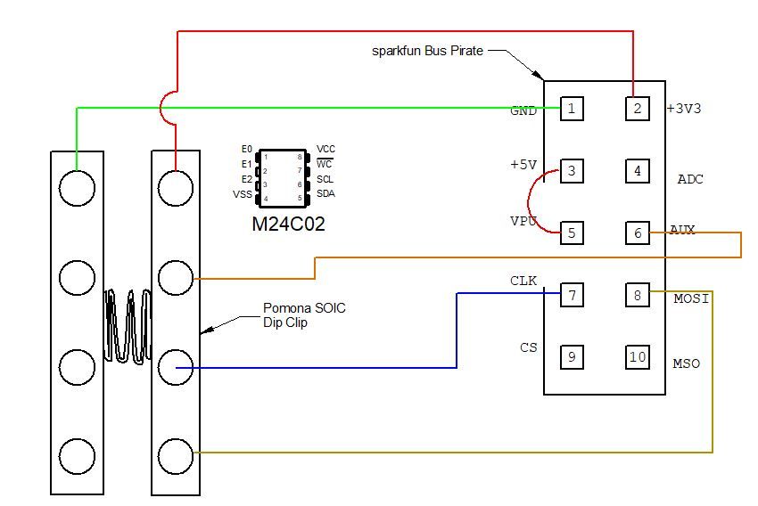

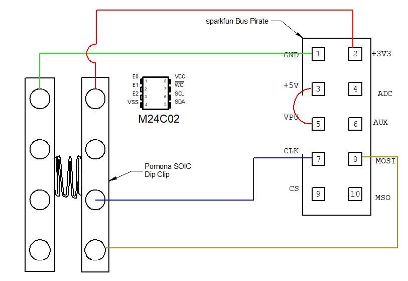

How do I write & save data to a 24c02 using a buspirate?
Options
2020-08-18 6:58 AM
I have wired up the Bus Pirate in this manner.
When I try to write data this is what I see:

So it appears the data I wanted write "This is a test" didn't get written.
Next I hooked up the Auxiliary pin .
Then I tried to write data again:

So even with Aux High or Low I still seem to be unable to change the data in the eeprom.
Any Ideas would be appreciated.
