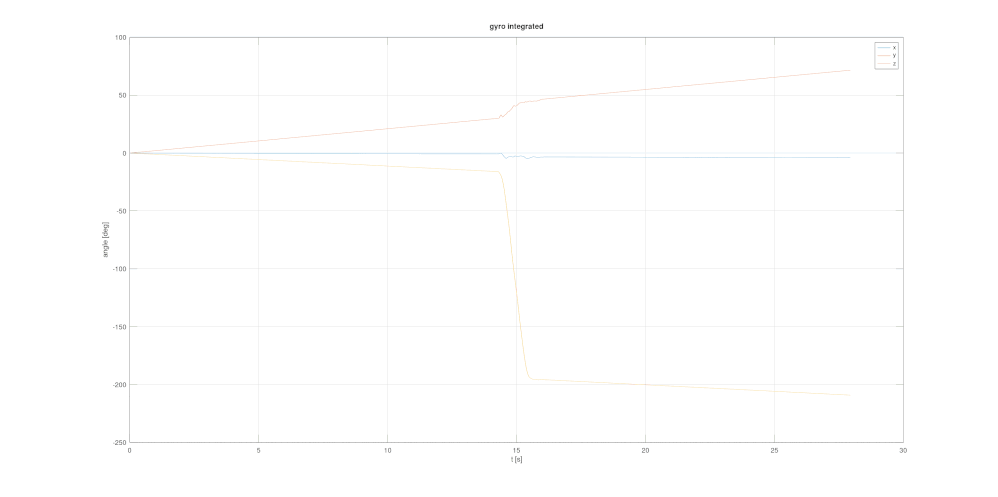

I'm going on with the testing, and there is still something that I don't understand.
To validate the setup, I rotate the device a by 360° round the z axis, while integrating the gyro. The integration is the accumulation of the gyroscope raw samples multiplied by the sampling interval. The integrated gyro should show a rotation of 360° and of course I expect also to see some drift because of the offset.
I'm using 200Hz sampling (sensor set to 208Hz), 500dps full scale and 0.0175 as sensitivity.
The result is shown in the image:
Looking at the yellow trace (which is the integrated Z axis of the gyro) it is clear that the measured rotation angle is closer to 180° rather than 360°. So it seems that the gyro is using a different FS setting.
I'm using this funtion to set the FS
LSM6DSO32_GYRO_Driver.SetFullScale(&lsm6dso32_obj_0,500)
Am I missing something else?

2021-07-02 8:32 AM
the problem here is not an overflow, I feel to exclude it since the device is set to 500deg/s and I was rotating the device with the hand (the full rotation takes 2-3s, it cannot be more than 500deg/s).
The problem is that when I rotate the device for 360deg, the accumulation/integration of gyroscope data returns aproximately 180deg (what you see in the yellow trace of the image in previous post) and not the expected 360deg.
In this test, the fullscale is set to 500deg/s using the provided drivers and the sensitivity is therefore 0.0175deg/slsb
2021-07-05 5:34 AM
Hi Davide,
ok it's clear, it looks a scale issue, effective.
But is the value on the other axis the correct one? And are you integrating with the correct time-base?
And what if you change the gyro FS, for example to 1000dps?

2021-07-09 8:20 AM
Hi Eleon,
there was a problem in the data preprocessing in matlab and I was discarding half of the samples, therefore the sampling interval was doubled, that's why I had to multiply by two the sensitivity to get consistent results.
Now the gyroscope works as expected.
