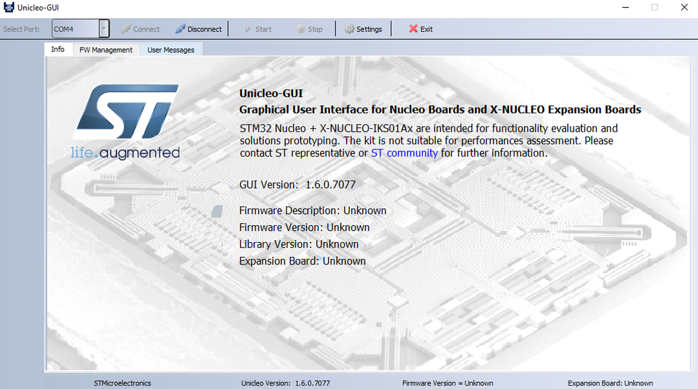

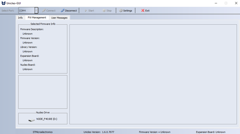

Hi I'm testing Unicleo & IKS01A2 for the first time, the software does not recognise any nucleo boards (F401RE & L476RG). If I "list all COM ports" I can connect but the board and firmware is stated unknown. I use Win10, any hints?

You have to program your Nucleo board with one of the application or DatalogExtended example. You can find all applications and examples in X-CUBE-MEMS1 package.

I got the MEMS package, I'm I supposed to compile any of the example projects and flash before i launch Unicleo?
Miroslav BATEK
Yes, if you want, for example, to test the sensors on IKS01A2 you can start with DatalogExtended firmware. There is already compiled binary file which you can use, just program the board with the binary file.
FZ
Got it running, Thanks!
