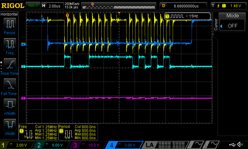

CLi.11
0693W00000JOTfRQAX.pngall read are zero for me (CS pull down when boot)
