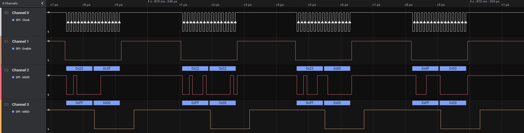

No matter what register I attempt to access, the MISO line puts out one byte of 0xFF and one byte of 0x00. See the attached logic analyzer screenshot, which shows writing to 3 CTRL registers and then attempting to read the WHO_AM_I register. The SPI traffic in the screenshot is the first to occur after powering the board on.

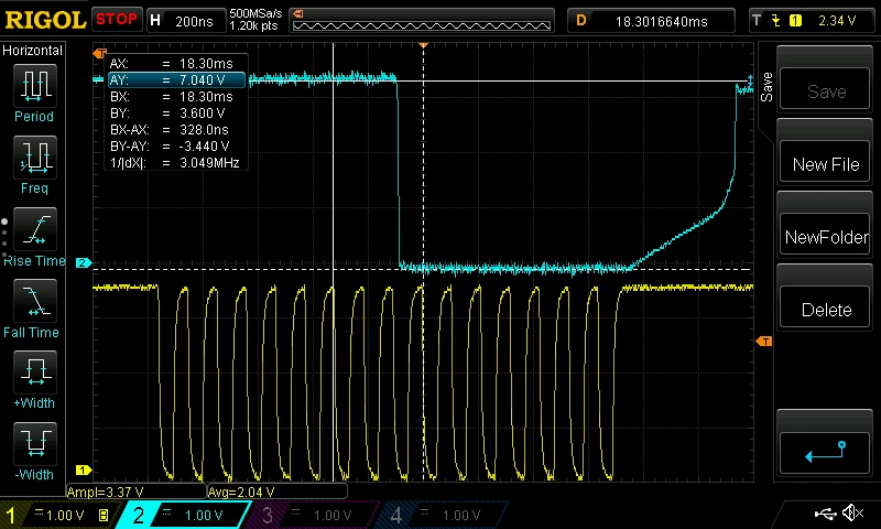

I did notice that the MISO line has an unusual "long tail" after the low byte; see the attached oscilloscope capture which also shows the SPI clock. That might be a symptom of some fundamental problem, but isn't a problem in itself.

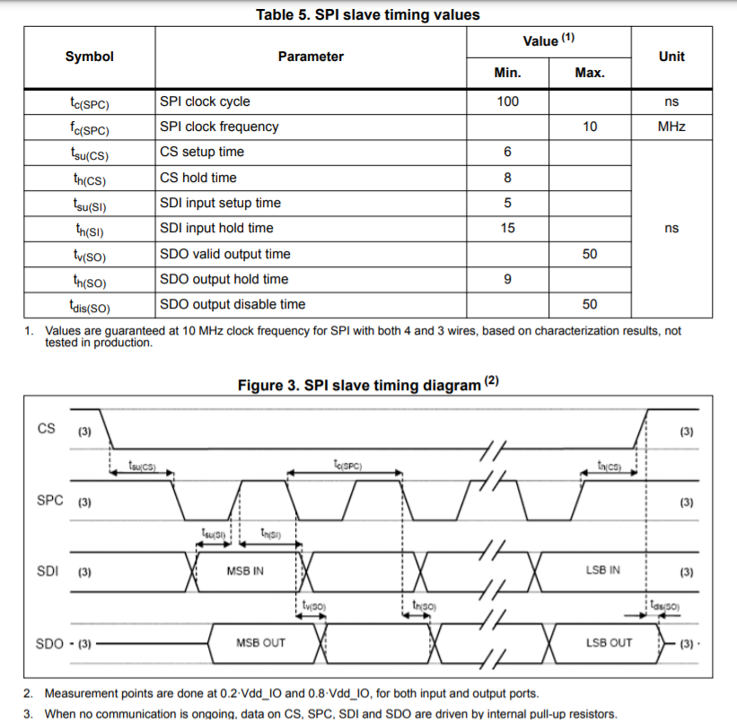

Another point to test is to check the timings you can find in the p.11 of the datasheet:
Can you confirm they are fulfilled?

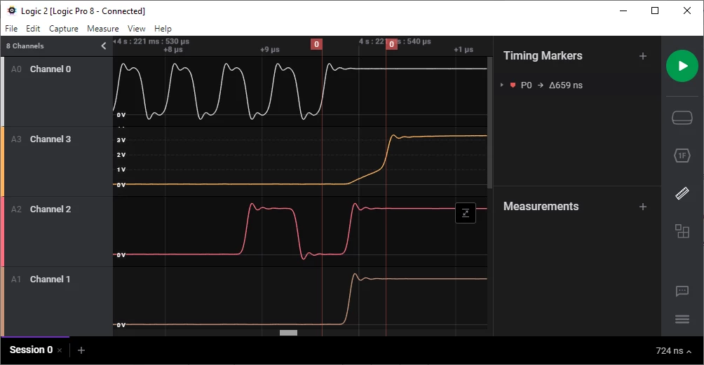

All of the timing parameters are met except for t_dis(SO), which is very out of spec at ~650 ns (compared to the maximum 50 ns spec). See the attached screenshot. This may point to damage to the H3LIS331, I'm not sure. I don't have access to the pads themselves, only the traces as they leave the chip footprint. I have applied pressure on the chip to try and force contact, but I didn't see a change in behavior.
