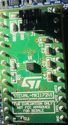

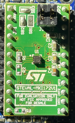

Hello ST Community!
Please help with resolving issue with WHO_AM_I register!
Firmware that I'm using on MKI109V3 board is V3.65.5.
Hello @Federica Bossi,
I've Unico 9.17.0.0, firmware version is V3.65.5.
Looks like ST shipped me MKI172V1 with burned out LSM303AGR IC.
I've resoldered it from my board. Now it works!
Original:
Resoldered:
