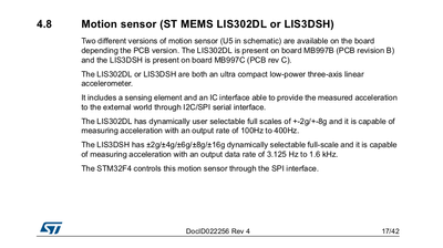

2025-10-05 10:19 PM
A quote from the user manual :
So, yes.
My goal is to implement tilt or motion detection completely in bare-metal C without HAL drivers.
I suggest to get the "legacy" SPL-based firmware package and demo code, and strip it down to your needs. It should still be available for download on ST's site.
The F407 discovery came before "Cube/HAL", the SPL is much lighter in this regards, and much better tested than most current Cube code. I use the SPL for projects involving the F407 and similiar "old" MCUs myself.
