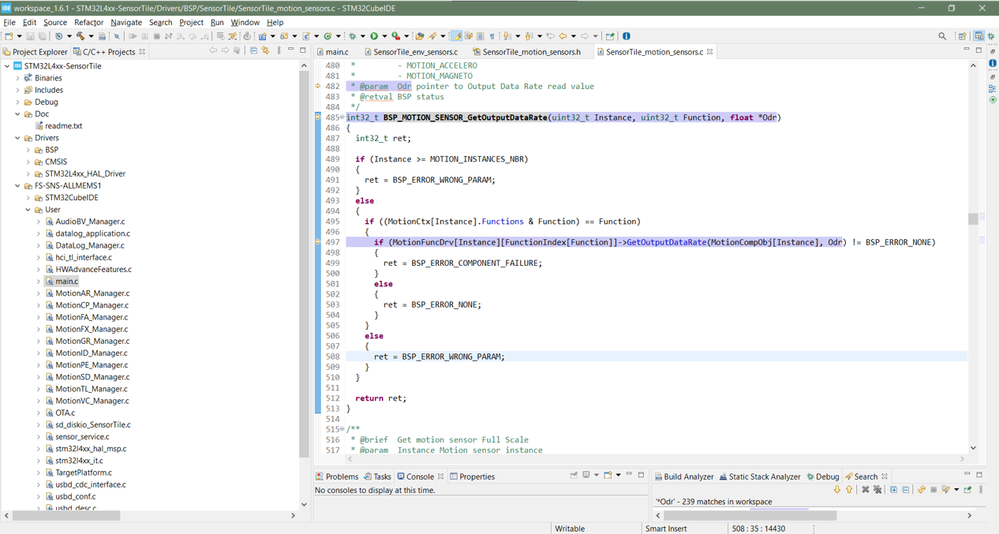

I programmed the sensorTile STEVAL-STLKT0V1 with ALLMEMS1 end I used STM32CubeIDE with NUCLEO32.
How I can change the sampling frequency (ODR) of accelerometers and gyroscopes?

Hi Chiara @CRoma.1​ ,
you can call the function BSP_MOTION_SENSOR_SetOutputDataRate (you can find it in the SensorTile_motion_sensors.c file) to set the ODR of your sensor before turning it on.
keep in mind that depending on which function you are using inside the application, you should call the function in different points in the program.
I hope this helps.
Niccolò

Thank you for your reply. I'm sorry but I'm new to programming. This is the screen of my program, but i didn't understand where i have to enter the sampling frequency i would like.
I would be happy if you could help me, thank you.
I tried to change the datalog rate on my part but with this firmware it is not possible to easily change the rate for datalogging.
(it is organized with a timer that must be changed along with the ODR, but it is programmed to be used with seconds in between samples and would not work just by changing 2 parameters)
There is a way to use debug console to have something like 5 Hz datarate, but even that is not easy.
can I ask you which ODR were you thinking of? (you wanted low data rates like 52Hz or much higher?)
maybe I can find some other firmware that can help you
Niccolò
