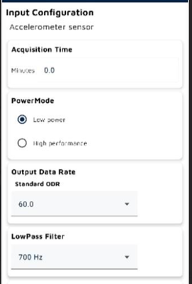

I'm working with MKBOXPRO and I'm using the Entry/Expert Firmware to send to my app via bluetooth accelerations and gyro speeds. I think default ODR is 60 Hz for both datas.
How can I modify ODR and increase it?
In case there isn't a way to do it wiithout coding which files of which fimrware I have to modify?

Hi @Claud_IAC ,
Please, refer to the user manual for more details.
For your application to have 60Hz both for ODR gyro and XL you can follow these steps:

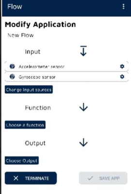

After connecting to the board, click on FLOW -> Expert view -> New app

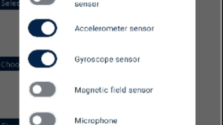

Then click on Select Input and follow these screenshoots:
Finally, click on the gear (near the label Accelerometer and Gyroscope) for each sensor to change the ODR:
Select output as STREAM TO BLUETHOOT
At the end save this flow and click the arrow near the flow name to load the flow on the board:
Come back to the first page with all the boards available and reconnect your board to see the outputs on plot data.
