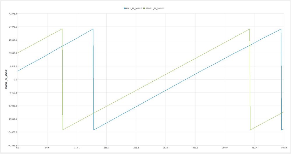

I tried measuring Estimated and Hall Elec. angles using Graph in Motor Pilot. But cannot increase the no. of cycles? Can I able to change the x-axis scaling? Because its difficult to calculate placement electrical angle using this reading.

Good progress, your plot is pretty nice, I think you have already something functional with Hall sensors as primary sensor, even if it is not optimal.
We are thinking of an application on top of mPilot to automatize all this process.
From what I see, the angle computing by the Hall sensor algo is Ok. so the Issue with your oscilloscope plot is probably due to a signal conflict on your board with DAC output.
Anyway, the shift can be tuned by dichotomy, the variable to change is HALL_M1->PhaseShift you can change it while your motor is spinning.
(another option would be to record the plot, and do a post processing with a tool like scilab or matlab.)
Regards
Cedric

I calculate the angle displacement by manual calculation and find it is equal to 300 degree(default one). But however during our discussion on 04/10/2021, I just tried using default angle and motor rotates using Hall sensor as main sensor. Today it is not rotating again ??

Once you changed your angle, are your two curves superimposed ?

So if we change the placement electrical angle, the measured angle and STO_PLL_angle should superimpose?? If yes, then need to use the same angle in the project where Hall Sensor as primary sensor ??
2021-10-07 01:39 AM
Yes, and yes, the purpose of having both angles plot at the same time is to compute the placement electrical angle to have both curves superimposed. This angle is actually a motor characteristic so it should be set for all the project using this motor, without distinction between primary or auxiliary sensor. The usage of auxiliary sensor is just a trick to be able to compute this placement angle.
