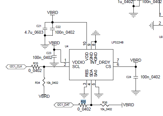

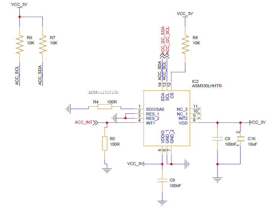

Here I used BLUENRG-LP SoC with ​ASM330LHH. We have the same schematic design in steval-IBD11V2A, like the first image. The second one is our schematic design.

I don't know what's the problem. My guess is the set timing is wrong. Because I tried many times with different value.
