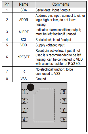

First of all, please check sensor pins : (SCL / SDA)
  • The communication must be with I2C protocol .

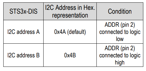

  • Check the I2C address for the sensor :
0693W00000Y9DwWQAV.pngFinally, open STM32CubeMx and start the configuration. :D
