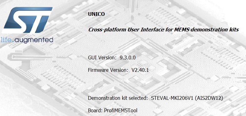

I get an error when connecting to the board that the WHO_AM_I register value does not match the device selected. The correct device does appear in the Unico GUI menu (STEVAL-MKI206V1 (AIS2dw12). I also have updated my firmware today, the demo board firmware version is: 3.6.13. I am able to verify the WHO_AM_I register on my own fixture (0X44). But I wanted to use the demo board to exercise some more functions as a reference for my own board.

Hi @CBalt.1​ , AIS2DW12 is currently supported by the last Unico version, as shown in the picture below:
I would suggest you to check if you plugged the audio adapter in the right orientation, to be sure the USB cable is not power-only and if the device you have in hand is effectively an AIS2DW12. Do you maybe have other samples / eval board to do the connection check?
