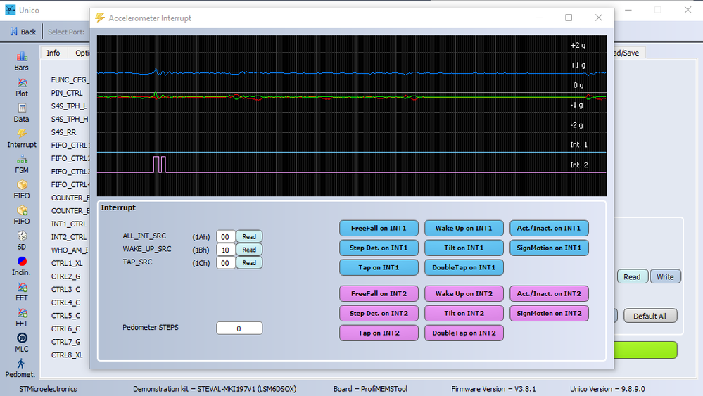

About the overflow event, you can detect it by reading (in polling mode) the FIFO_ OVR_IA bit FIFO_STATUS2 (3Bh), Otherwise, It is possible to route for example the FIFO_WTM_IA flag of FIFO_CTRL2 (08h) to the INT1 pin by writing in register INT1_CTRL (0Dh)(INT1_FIFO_TH) = '1' or to the INT2 pin by writing in register INT2_CTRL (0Eh)(INT2_FIFO_TH) = '1'. Then you can plot it on the Unico-GUI interrupt panel.

For the interruption of FIFO OVF or FULL, none of pin interruption at both INT1 and INT2 were observed.
I might be wrong. Please kindly review below instruction at (2). I sent those command before sending '*start' command to the board.

>> For the interruption of FIFO OVF or FULL, none of pin interruption at both INT1 and INT2 were observed. I might be wrong. Please kindly review below instruction at (2). I sent those command before sending '*start' command to the board.
I would suggest you to set the interrupt pins after the FIFO mode setting. Then you can try to read the FIFO_OVR_LATCHED bit of the FIFO_STATUS2 register before starting a new FIFO reading, to check if you are not just missing the INT1_FIFO_OVR for some reason.
