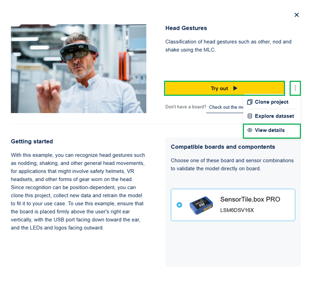

To begin, click on the "Head Gestures" project available inside the Project examples. A pop-up window appears with a brief description, as shown in Figure 1.
Next, click on the three vertical dots next to the [Try out] button and select [View details]
Figure 1: Head Gestures project
This reveals that the project uses a single AI model named head_gestures, targeting the SensorTile.box PRO and the IMU LSM6DSV16X with a machine learning core. The model classifies data into three categories: nod, shake, and other (which is a category embedding all other possible gestures).
Figure 2: Head Gestures: a ready-to-run use case

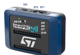

- Update the firmware: Connect the SensorTile.box PRO to your PC using a USB Type-C® cable. Turn on the board in DFU mode by holding down user button 2 (BT2) and powering on the board via the power switch (SW) (see Figure 4).
Figure 4: Turn on the board in DFU mode
