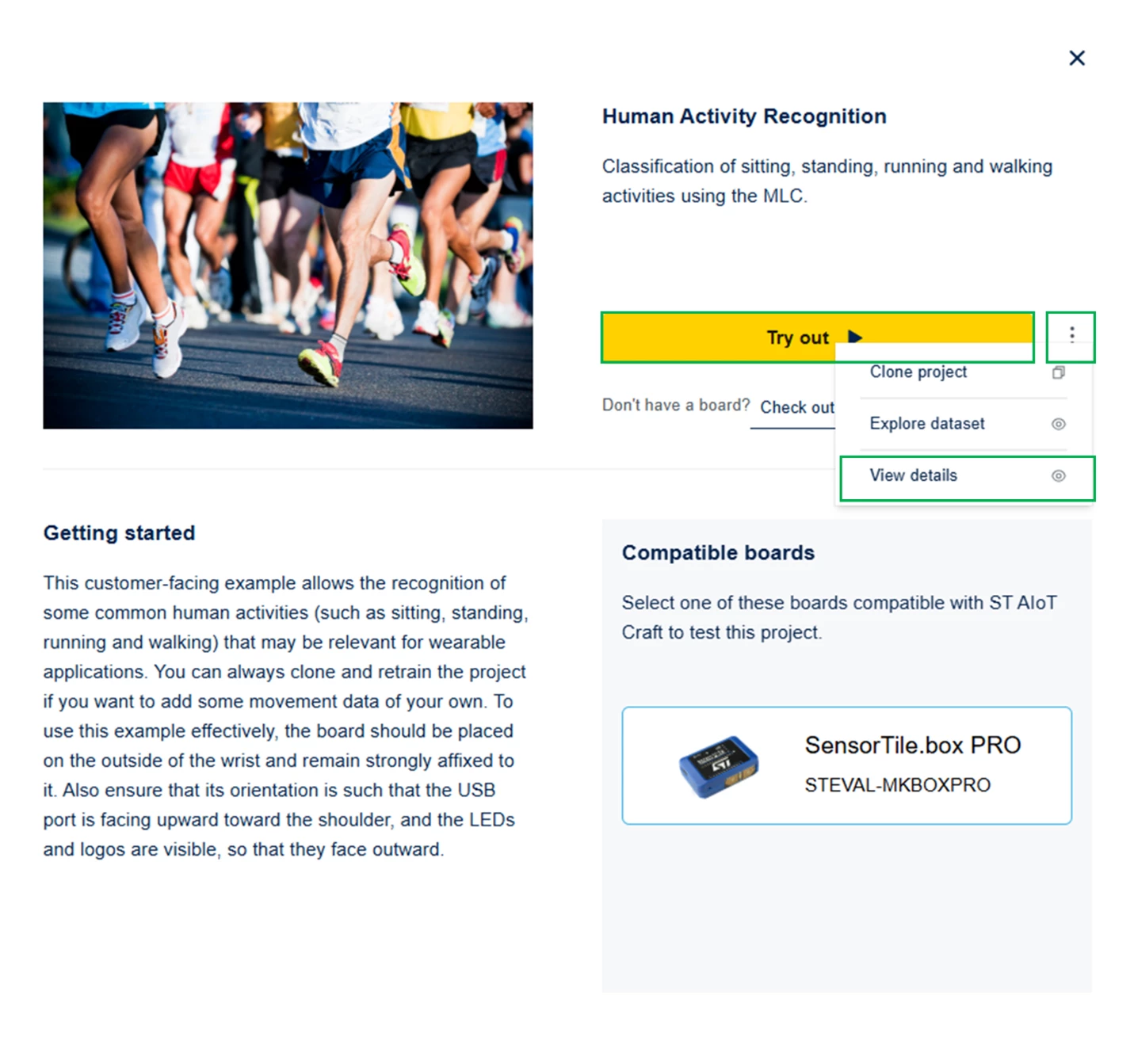

To begin, click on the human activity recognition project available inside the project examples. A pop-up window appears with a brief description, as shown in Figure 1.
Next, click on the three vertical dots next to the [Try out] button and select [View details].
Figure 1: Human Activity Recognition project

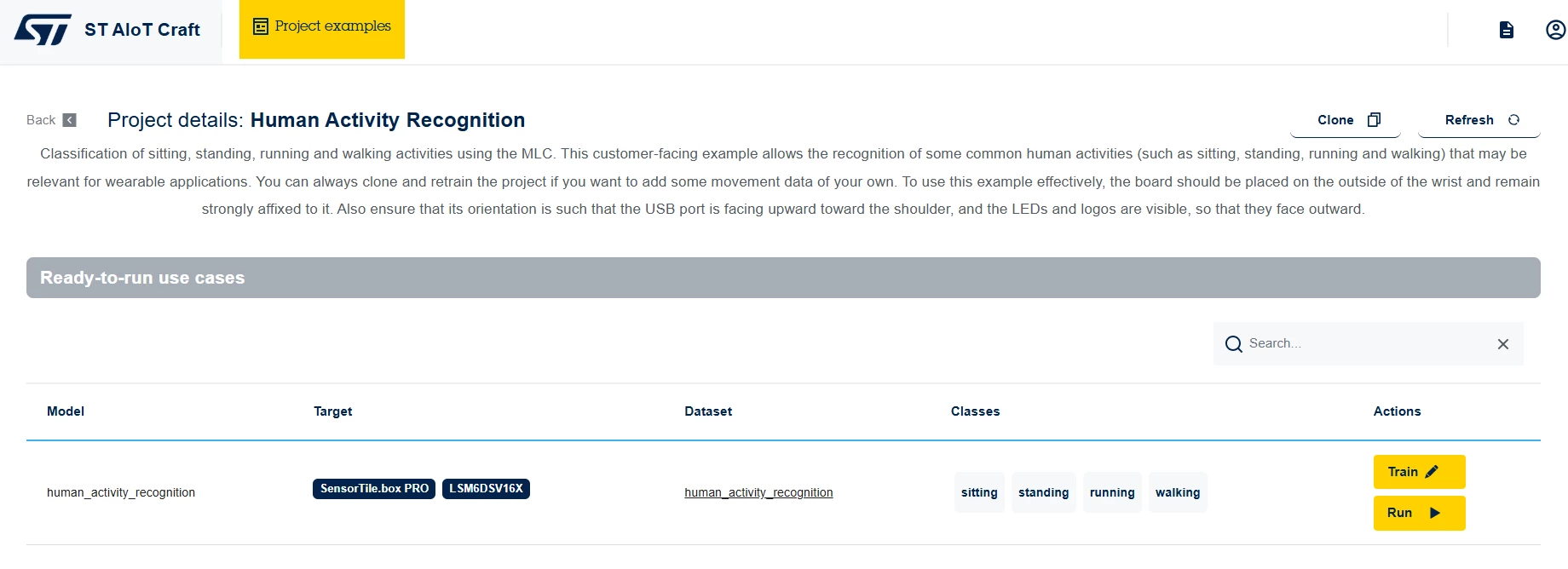

This reveals that the project uses a single AI model named human_activity_recognition, targeting the SensorTile.box PRO and the IMU LSM6DSV16X with a machine learning core. The model classifies data into four categories: running, walking, standing, and sitting.
Figure 2: Human Activity Recognition: a ready-to-run use case

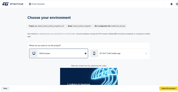

You can evaluate the AI model either through the web application or via the mobile app. If you choose the mobile app, QR codes for installation are provided.
Figure 3: Choose your environment: either Web browser or ST AIoT Craft mobile app
For now, let's focus on evaluating the AI model directly on the web application using the SensorTile.box PRO.

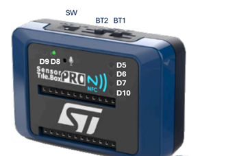

- Update the firmware: Connect the SensorTile.box PRO to your PC using a USB Type-C® cable. Turn on the board in DFU mode by holding down user button 2 (BT2) and powering on the board via the power switch (SW).
Figure 4: Turn on the board in DFU mode
- Flash the firmware: Click the [Flash firmware] button to download and stream the firmware binary to the board. Ensure that your browser detects the connected SensorTile.box PRO. Once the firmware update is complete, establish a connection with the board by clicking the [Connect device] yellow button.
