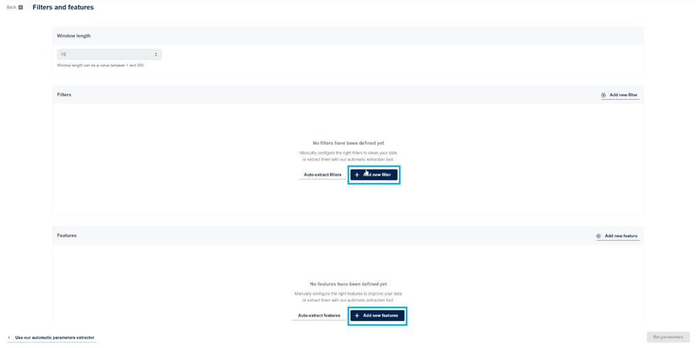

3. Manual parameters setting
Apart from using the automatic parameters extractor, you can also set window length, filters, and features manually.
Figure 1. Add new filters and features manually by clicking on the blue buttonsFigure 1. Add new filters and features manually by clicking on the blue buttons
All parameters must be selected carefully so that the requirement of minimum number of samples in each file is satisfied.
Files within the dataset were acquired with certain output data rate (ODR). If it was acquired with a rate higher than MLC ODR, the data is sampled down to the value of MLC ODR. There must be enough samples in each file to have at least one window of data.
The number of samples in one window is calculated according to the equation below:
Samples = max(Oa, Og) / Om * wl
  • Oa stands for accelerometer ODR.
  • Og stands for gyroscope ODR (if gyroscope data are used for model training)
  • Om stands for MLC ODR
  • wl stands for window length

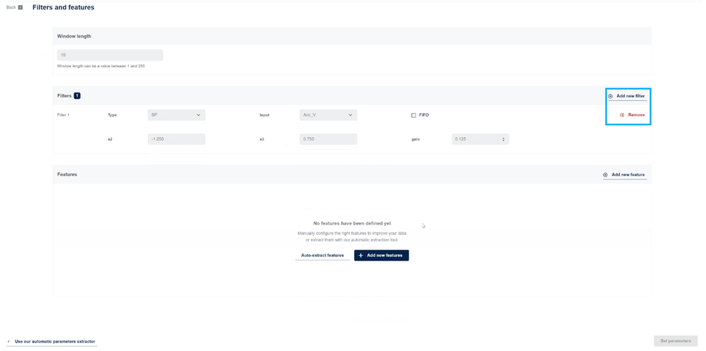

3.1 Filters
Figure 2. Filters can be added with Add new filter button and deleted with Remove button for respective filterFigure 2. Filters can be added with Add new filter button and deleted with Remove button for respective filter
There are four types of filters:
  • HP (High-Pass): to remove low-frequency components, allow high-frequency signals to pass;
  • BP (Band-Pass): to allow signals within a certain frequency range to pass through;
  • IIR1 (first order infinite impulse response): a type of digital filter used for various filtering tasks with a single stage;
  • IIR2 (second order infinite impulse response): a type of digital filter used for various filtering tasks with two stages, more complex filtering capabilities than IIR.
Each filter must have one of the following inputs: Acc_XYZ, Acc_V, Acc_V2 and Gyr_XYZ, Gyr_V, Gyr_V2 that are only available when gyroscope is selected as the input data source.
Filters with inputs ending with "_XYZ" are calculated from individual axes, with inputs ending with "_V" being calculated from norm and with inputs ending with "_V2" calculated from norm squared.

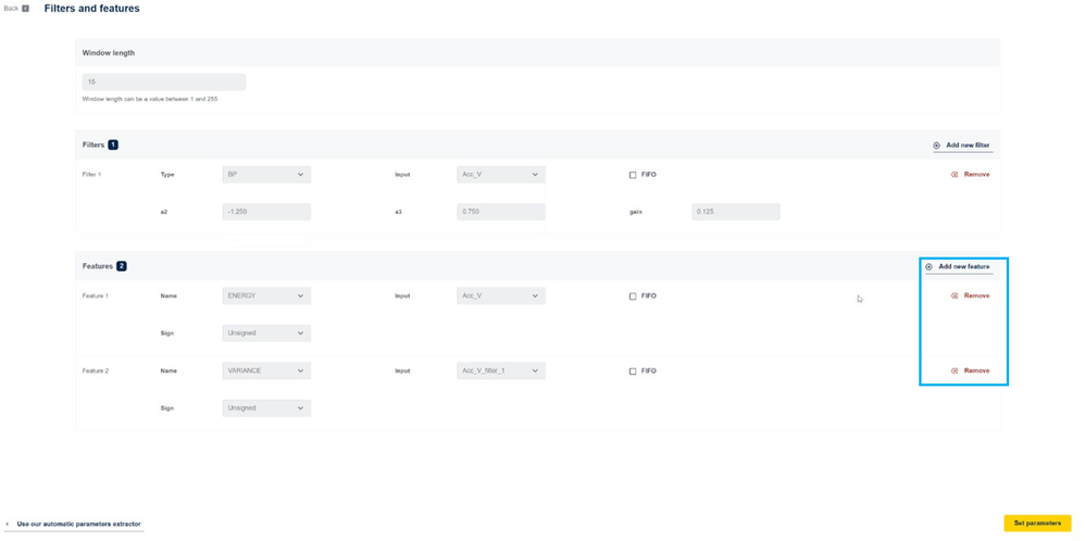

3.2 Features
Figure 3. Features can be added with Add new feature button and deleted with Remove button for respective featureFigure 3. Features can be added with Add new feature button and deleted with Remove button for respective feature
There are 12 types of basic features: mean, variance, energy, peak to peak, zero-crossing, positive zero-crossing, negative zero-crossing, peak detector, positive peak detector, negative peak detector, minimum, maximum.
Features can be computed either from raw sensor input data.
In that case, each feature must have one of the following inputs: Acc_X, Acc_Y, Acc_Z, Acc_V, Acc_V2 and Gyr_X, Gyr_Y, Gyr_Z, Gyr_V, Gyr_V2, which are only available when gyroscope is selected as input data source.
Additionally, features can be computed from filtered data. In that case, there are also possible following inputs:
  • Acc_{axis}_filter_{filterIdx}
  • Gyr_{axis}_filter_{filterIdx}
For example, input Acc_X_filter_3 means that there is an applied filter with index 3 on X axis of accelerometer. Filter 3 must be declared with Acc_XYZ input.
