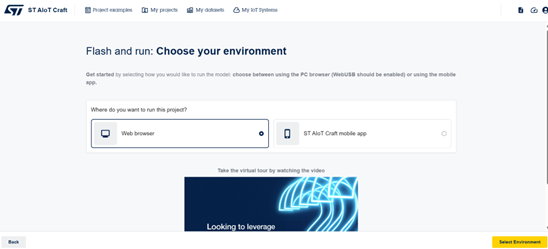

4.1 Choose your environment
Select [Web browser] or [ST AIoT Craft mobile app].

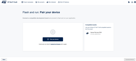

4.2 Firmware update
Connect the SensorTile.box PRO to your PC though a USB Type-C® cable, turn on the board in DFU mode.
If needed, refer to section 2.2 “How to program the SensorTile.box PRO in “DFU mode (via USB)" of the user manual UM3133 about SensorTile.box PRO).
Click the [Flash firmware] button to download and stream the firmware binary to the board. Ensure that your browser detects the connected SensorTile.box PRO.
Figure 3: Pair your deviceFigure 3: Pair your device

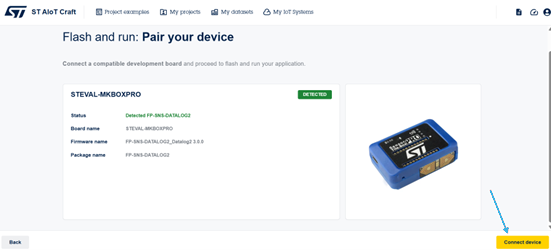

Once the firmware update is complete, establish a connection with the board by clicking on [Connect device].
Figure 4: Connect the deviceFigure 4: Connect the device

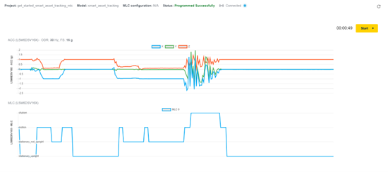

4.4 The evaluation phase
Click the [Start] button to begin evaluating the AI model. The SensorTile.box PRO recognizes the following states based on its placement and movement:
  • Shaken: Recognized when the board is shaken.
  • Stationary upright: Recognized when the board is stationary and upright.
  • Stationary not upright: Recognized when the board is stationary but not upright
  • Motion: Recognized when the board is moved.
Figure 5: Start evaluating the AI modelFigure 5: Start evaluating the AI model
To end the evaluation, click the [Stop] button.

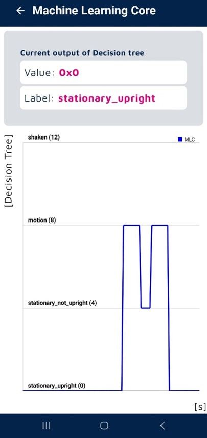

5. Mobile app evaluation
For wireless tracking, the ST AIoT Craft mobile app can be used.
You can download the app using the QR codes provided for easy installation which appear when you choose ST AIoT Craft mobile app as the working environment (see Figure 2).
Figure 6: Evaluate the AI model via the mobile appFigure 6: Evaluate the AI model via the mobile app
