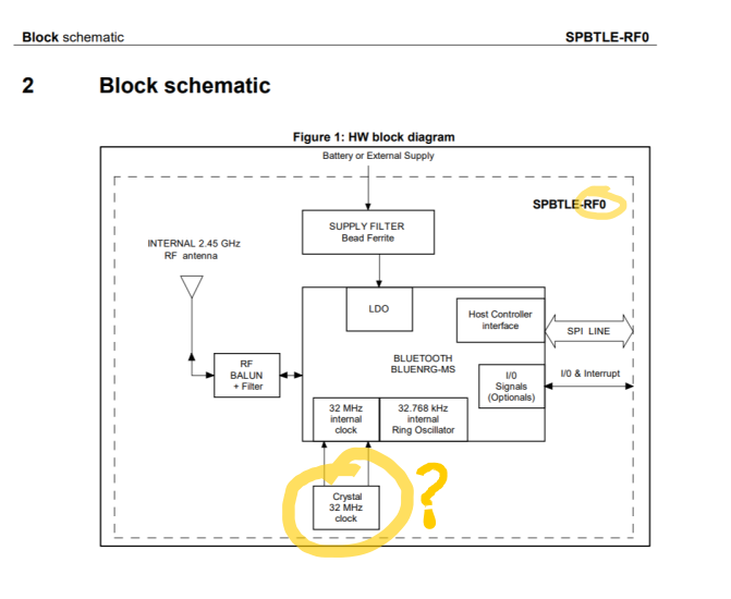

We can find the
SPBTLE-RF0 much easier here, so will be testing that in the design.
As far as I can see, the only differences are in certifications and Tx/Rx current consumption unless anyone knows anything different ?
Thanks
Posted on June 28, 2018 at 11:48
RF/RFTR: SMPS power supply, LSE (32KHz) crystal, TELEC (Japan) certification
RF0/RF0TR: LDO power supply, no LSE crystal
Posted on June 28, 2018 at 12:29
Thanks for the info.
Does that mean the datasheet is wrong...
Posted on June 28, 2018 at 13:22
Do not confuse BlueNRG's mandatory HSE (16, or 32MHz here) with optional LSE (32KHz)
Posted on June 28, 2018 at 13:43
Sorry, I immediately read it as 32Mhz, not Khz.
Thank you
