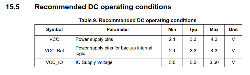

I would like to connect a TESEO LIV3F to an STM32 MCU that is powered using a 2.4v supply.
Im wondering if I can drive TESEO's Vcc_io with a 2.4v supply or if I should use a 3.3v according to the datasheet and put a level shifter between them both.
The first option is far the best for me ...

In fact, in the recommendations there is a different power range for the VCC_IO.

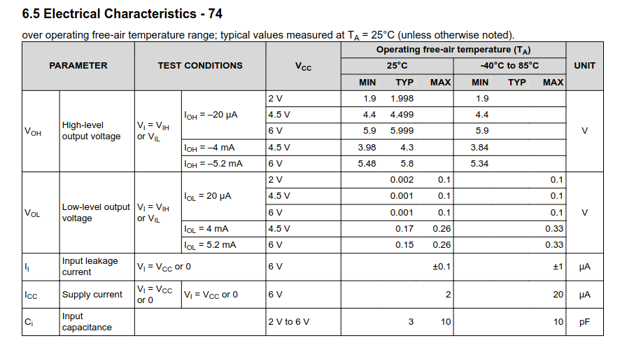

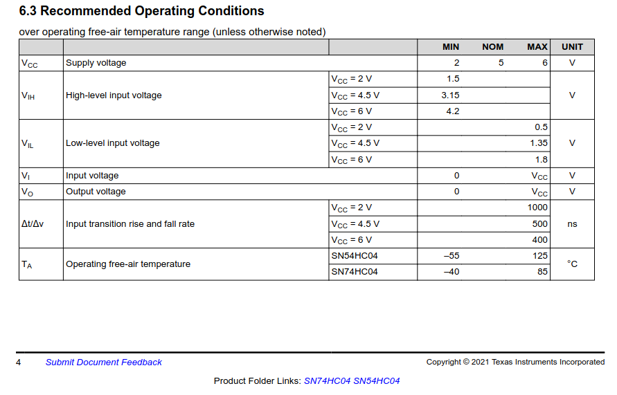

Manufacturers usually inform the values of VIH, VIL and VOH, VOL so that the user can confirm whether it will be possible to meet the parameters, but I did not find this, really weird. For example a datasheet of SN74HC04:

Since it's the same technology than the STM32, I assume that, for the TESEO LIV3F, the minimum voltage for HIGH level is 3.3 * 0.7 = 2.31V.
The STM32 that communicates with it outputs a voltage for HIGH lvl between 1.95v and 2.4v so It may not work sometimes.
I need to figure out if it's possible to connect it directly to 2.4v and operate the I/O pins correctly.

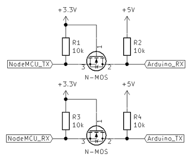

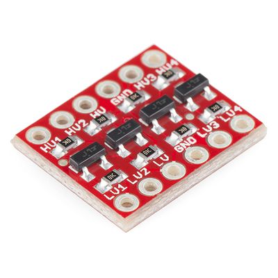

What type of data bus are you using? UART or I2C? It might be possible to implement the shift level using discrete components.
E0658944_level_shift_uartE0658944_level_shift_divider
Image sources: https://www.okdo.com/project/level-shifting/
AO3400 Gate Threshold Voltage: 1.45V and AO3401 Gate Threshold Voltage: 1.3V
