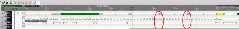

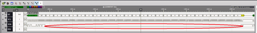

I have derived this code from the ST25NFCLib, and the software works correctly when interfacing with the NUCLEO-L476RG board.
However, when I connect the same setup to my proto board, I observe a difference during the following I2C transaction.
During the initialization process, the master sends command 0xDF (Measure Power Supply) and then waits for the IRQ signal.
In the working setup, the IRQ status registers (1Ah–1Dh) return the values:
00, 80, 00, 00
Whereas in the non-working setup, the IRQ status registers return:
00, 00, 00, 00
I am not sure why the IRQ response is different in the proto board setup.
Please note the following:
  • Both the working and non-working setups use the same ST25R3918 daughter board.
  • Both setups use the same interface signals: 3.3V, GND, IRQ, SCL, and SDA.
  • The I2C communication speed is identical on both setups.
I am attaching the I2C transaction screenshots for reference:
  • The upper transaction belongs to the non-working setup.
  • The lower transaction belongs to the working setup.
Please let me know if you notice any missing initialization command or any issue in the sequence below.

NFC 5 Click board is not a board designed by STMicroelectronics. Compared to X-NUCLEO-NFC06A1 (ST25R3916), the pull-up resistors are 4.7 kOhm (vs. 1.6 kOhm on X-NUCLEO-NFC06A1). I recommand to check the signal integrity with a scope and to make sure SCL and SDA signals reach valid logic high levels fast enough. Check also the SDA GPIO settings on your MCU (no internal pull).

what I see on the NUCLEO-L476RG trace:
For sure, the I2C signals are not clean. I see also spikes on the IRQ line.
What I see on the proto board:
After the first byte sent by the ST25R3918, the MCU seems to keep SDA to 0 (ACK). This is clearly an issue on I2C.
Could you check you I2C driver regarding the ACK management after the first byte being received?

Hi Brian,
Great news — I found the problem in my I2C driver. Your feedback helped me identify and resolve the issue.
Thank you very much for the help. It is greatly appreciated.
