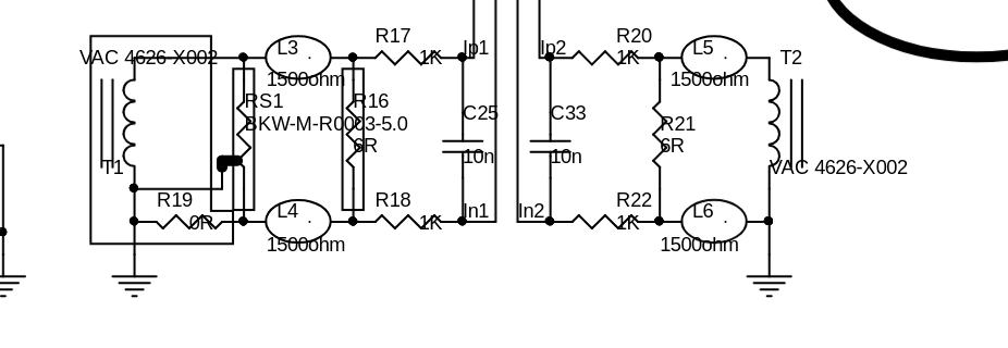

Hi everyone,
I met a problem when I measured the current rms value with stpm33 ic.I'm using this IC with resistive loads and other load profiles with low crest factor. But I met a case with a high crest factor load like as SMPS type loads.

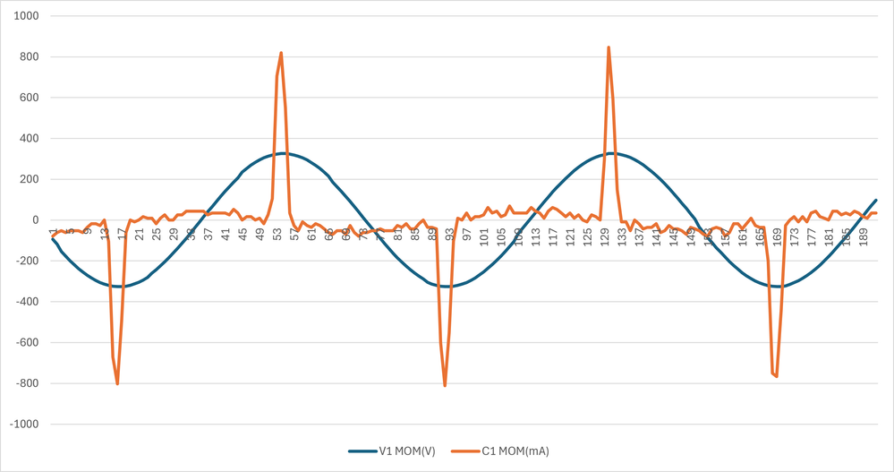

You can find my measured values and voltage-current graph at below.
Blue: Actual Voltage Orange: Actual CurrentBlue: Actual Voltage Orange: Actual Current

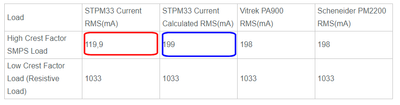

Load STPM33 Current RMS(mA) STPM33 Current Calculated RMS(mA) Vitrek PA900 RMS(mA) Scheneider PM2200 RMS(mA)
High Crest Factor SMPS Load 119,9 199 198 198
Low Crest Factor Load (Resistive Load) 1033 1033 1033 1033

I see circuits has LPF on both current inputs, likely the problem. You can try to de-solder cap's C25 / C33.

Thank you for your response. I have tried your suggestion before. I am afraid the problem is not hardware-related. Because I understand it from the actual values I collected using the same eval board. I think there is a structure where I can configure the method used by the STPM for RMS calculation or another register-level change. Otherwise, it would be strange if I were the only one encountering this problem.

Thank you for your reply. It seems that the focus is on the calculated value for the error ratio. However, I don't need the momentary value; I used it only for detecting the error in the RMS readout.
Let's focus on the table again, specifically the first and second columns for comparing the two RMS values. The first column and first row define the STPM33 RMS value read from the RMS register. The second column and first row define the calculated value from momentary points. There is a significant difference of about 40%.
OK - I'll colour it:
That's these 2 cells:
They only differ by 0.9 in 199 - that's under 0.5%

I am having some difficulty understanding your calculation, specifically regarding how you arrived at the 0.5% figure. If you could kindly explain this to me, I would greatly appreciate it. It is possible that there may be a formatting error related to the use of commas (,) and points (.) in the local text.
This is my calculation:
Measured value is 119.9 mA
Calculated Value is 199.0 mA
Error = 199.0 - 119.9 = 79.1 mA
79,1 mA / 199.0 mA = 0.397 = % 39.7
D'oh!
I was reading 119.9 as 199.9 !!
