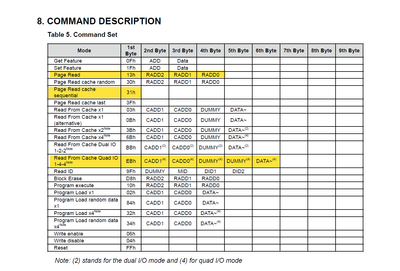

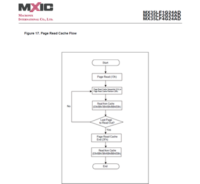

However, with the MX35LF1G24AD, it seems that data cannot be read directly from the chip. Instead, you must first issue a Page Read command to transfer data from NAND to the internal cache, and then use a Read From Cache command to access the data. For example:
// Step 1: Page Read (transfer from NAND to cache)
SendCommand(PAGE_READ_CMD, block, page);
// Step 2: Read From Cache (read from internal buffer)
SendCommand(READ_FROM_CACHE_CMD, column_address);
This makes me wonder: Can memory-mapped mode even work with this kind of NAND architecture, where a two-step read process is required?

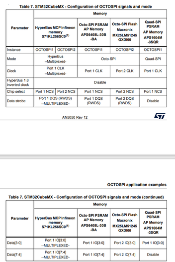

In order to start with OCTOSPI interface, you need to verify if this device is supported by the interface. The command format and order shared in the device datasheet must be aligned with the command format and order mentioned in the STM32 reference.
Check the STM32U5G9 errata sheet for any known limitations and workarounds.

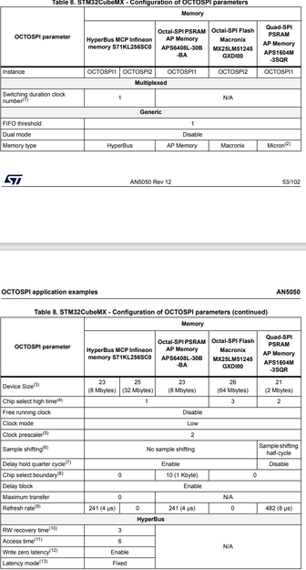

To configure the OCTOSPI interface using STM32CubeMX, I recommend you to look at AN5050 precisely section "7 OCTOSPI application examples".
This section provides some typical OCTOSPI implementation examples with STM32L4P5xx/Q5xx products, and STM32CubeMX examples. For that, You can refer to this section and get inspired to configure the OCTOSPI interface.
May Overall FAQs for QUADSPI/OCTOSPI/HSPI/XSPI FAQ can help you. The purpose of this article is to provide external memories tips and tricks, frequently asked questions, and a list for useful link resources.

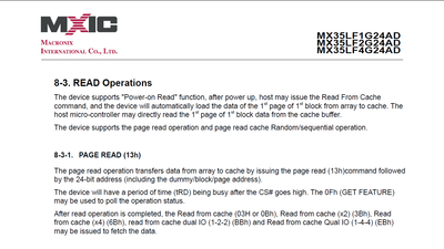

I did not mentioned it but I am already able to communicate with the NAND Flash, write data into it and read its content. The complex part is to correctly implement external flash memory mapping because each time that data needs to be retrieved from it, a "Page read" command needs to be sent before actually fetching its content (like shown in "Page Read Cache Flow" diagram and documentation pictures bellow).
How to enable memory mapped and map the entire flash in this situation?
