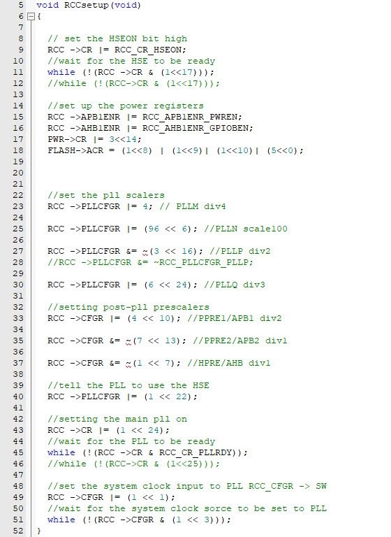

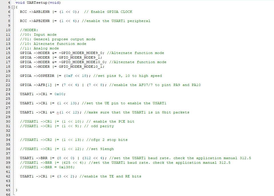

0693W00000DqJStQAN.jpg0693W00000DqJSjQAN.jpgI'm using a custom board with an 8mhz crystal clocked to 96mhz. the usart1 bus runs on 48mhz. this is the uart and clock configuration code
is that autogenerated with cubemx?
i meant show us where youre handling the RX and TX, also the arduino code

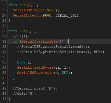

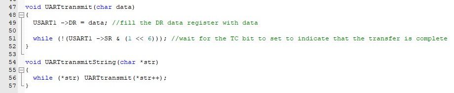

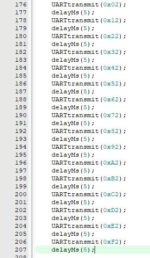

I have wrote it myself. here is the arduino and the TX code.0693W00000DqLOPQA3.jpg0693W00000DqLOKQA3.jpg0693W00000DqLNlQAN.jpg
whats wrong with USART_SendData()?
also the while(!USART.... (active wait ) should be checked before the transmission attempt not after.
