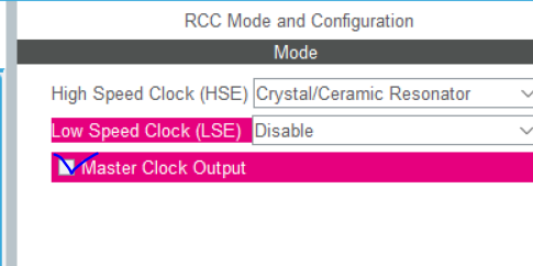

Problem solved. After a couple of days I have decided to check the uart with lower main clock frq and apparently it works under 86mhz
‎2021-08-26 01:09 AM
Congrats!, clock issues are not the easyest to spot.
Maybe your XTAL pcb traces have huge capacitance or you placed the sligtly bigger than needed capacitors?(or youre using one of those RC resonators instead of a xtal)
You can figure out the real clock your chip is using by probing with an oscilloscope very fast PWMs or outputing master clock directly to a pin.
‎2021-08-26 01:49 AM
It may be the problem. My capacitors on the xtal lines are 30pF. I have chose this based on the load capacitance of my ​crystal.
