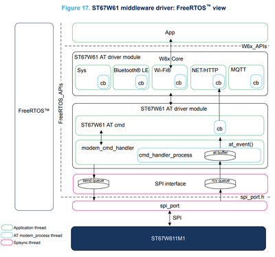

I'm using a host (STM32F7) communication with ST67W611 BLE WIFI via SPI.
So far, I can configure application P2P Client, T01 architecture, gen code and build pass.
The issue what I'm facing is I can't init SPI communicaiton with ST67W611. so Could you help me answer some question to debug what issue is?
1. I bought ST64W611, so Could I need to re-flash firmawre for this module?
2. the W6X_Init(0 function init failed, I checked the pin SPI_RDY alreay has level low (= 0).
so I hope if there is someone has worked with ST67W611 via SPI with a host STM32, please share me the experience?

It is indeed necessary to update the module binary as stated in the note here. The procedure is described in the same wiki page. Let us know if this solves your issue or if we need to look further into it.

My question is: how to migrate to generate the binary for my host ( STM32F7690.
Thanks,
Giang
The same way you'd migrate (aka "port") any other software from one microcontroller to another: identify which parts are specific to the particular microcontroller, and adjust them accordingly...
This is why we have layered architectures:
only the lowest layer - which deals directly with the SPI hardware - should be microcontroller-specific ...

Updating the ST67 binary is the first step. If you're able to flash it without using an STM32 then fine (maybe you use an USB/UART dongle to connect your PC to the ST67 UART pins, while controlling CHIP_EN and BOOT pins to boot the module from UART). The alternative would be to use the STM32 on which you'd port the NCP_loader project and then run the binary update script.
Once the ST67 is with the right binary, you could indeed connect it to your STM32 on which you run your ported p2p client application project binary. In this case, SPI is the communication interface between the Host and the ST67.
