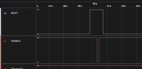

The Hardware that I setup in below:
1. USB-TTL connect to ST67W61 via TX/RX pin
2. PIN BOOT, ENABLE is to pull-up with 3.3V via SW1 (BOOT) and SW2 (ENABLE), see the picture in attachmentHW.png
3. The sequence that I did : press and hold SW2 (chip ENABLE), press and release SW1 (BOOT), then release SW2.
Do everyone has experience please help me to check whether my HW and sequence already correct or not?
Thank you very much!

By default the BOOT is pull down (33k) and the CHIP_EN is pull up (already inside the module, no need to add external pull up). So on the your schematic, the switch SW1 should be linked to 3.3V and to enter the boot mode, you have to follow this sequence:
- Press SW1 to keep BOOT at 3.3V.
- Push and release SW2: make a "reset".
- Release SW1.
Then the module is in BOOT mode and you should be able to flash the module.
Hope it will help,
Regards,
Damien.

Mar 19, 2026 7:43 AM UTC
Hi Giang,
I think I gave you a wrong information, there's no pull up on the CHIP_EN signal inside the module but the pull up is managed by the host (STM32). Can you detailed a little bit more your schematic ? how do you interface the ST67 (UART / SPI) ? Which host are you using ?
If you only want to to flash the module and control manually the CHIP_EN and the UART (no Host connected), you indeed need external Pull_up on CHIP_EN and Pull_down on the BOOT (see image in attachment).
In that Hardware configuration, your timing is correct.

Mar 19, 2026 3:36 PM UTC
If I understood your problem correctly, unfortunately I'm also seeing the same issue after installing t01 the first time. I'm unable to re-flash the ST67 again and for me the device seems bricked. I tried it on several boards and see the same issue. I have no problem re-flashing on boards with t02 installed the first time. It allows reflashing of t02 again and again. However, the moment I flash t01 successfully, the device gets bricked.
My workaround was to do a full chip erase before reflash
QConn_Flash\QConn_Flash_Cmd.exe --port COM38 --erase --whole_chip
After which I was able to flash either binary on ST67s

Mar 19, 2026 5:21 PM UTC
Not sure about the timings as I also do it manually via a switch. Here's an example of the start of a successful output

Mar 19, 2026 5:26 PM UTC
One other important thing if you are using your own custom board... your serial port must be able to support 2000000 (2M) baud rate. The flashing only works at that speed.

[17:06:17.173] - Get bootinfo time cost(ms): 2274.119873046875
[17:06:17.173] - change bdrate: 2000000
[17:06:17.173] - Clock PLL set
[17:06:17.173] - Set clock time cost(ms): 0.0
[17:06:17.311] - flash set para
[17:06:17.311] - get flash pin cfg from bootinfo: 0x08
[17:06:17.311] - set flash cfg: 1014108
[17:06:17.311] - Set flash config
[17:06:19.318] - ack is b''
[17:06:19.318] - Retry
[17:06:21.324] - ack is b''
[17:06:21.324] - Retry
[17:06:23.331] - ack is b''
[17:06:23.331] - Retry
[17:06:25.336] - ack is b''
[17:06:25.336] - {"ErrorCode": "003B","ErrorMsg":"CHIP FLASH SET PARA FAIL"}
[17:06:25.336] - Burn Retry
[17:06:25.336] - Burn return with retry fail
