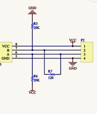

@Peter BENSCH thanks for the response. Then is it that the supply voltage Vcc (supply) will only be responsible for the peak voltage seen on the RO and DI lines interfacing with the MCU (STM32 in this scenario)?
On the A/B side (which interfaces with the external device i see that the A and B lines are always pulled up to 5V -
All the schematics show this. Maybe a bit out of context, but would be really helpful why this pull up is required.
The pullup/pulldown pair is used to give the signal a known state when the chips are not powered. This avoids floating inputs when chips are in a reset state or being powered up. After the chip is powered, these are no longer needed, but of course they're still there.
Lots of RS485 receiver chips can detect open lines and will default to a high state if inputs are not connected.
Nilav
Thanks @TDK . Appreciate the succinct response. Makes sense.
