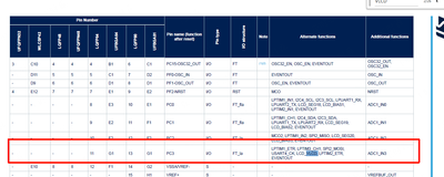

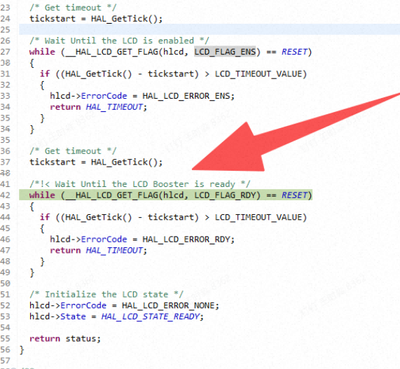

I'm using the LCD of the STM32U073K8, but the program failed to initialize the LCD. After checking, I found that the STM32U073K8 doesn't have the VLCD pin. Is the STM32U073K8 not compatible with the LCD peripheral? Or are there other settings?

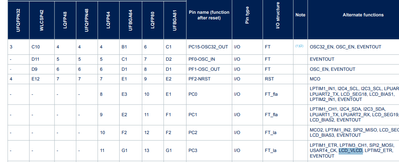

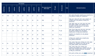

So 32 pin case has no Vlcd pin.
But if pin not present...no cap here possible.
So you picked the only case without vlcd pin.
Take the next one ...with vlcd pin.

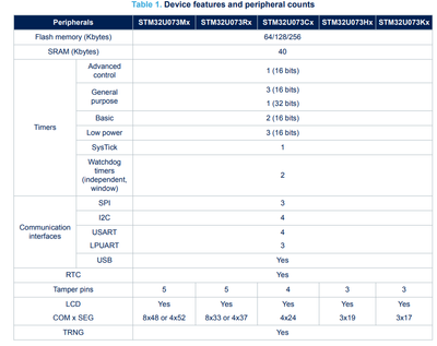

I'd say, in that case, the DS should not advertise this package to support LCD, in Table 1.
Unless VLCD is connected to VDD internally in this package; in which case this fact has to be documented properly.
