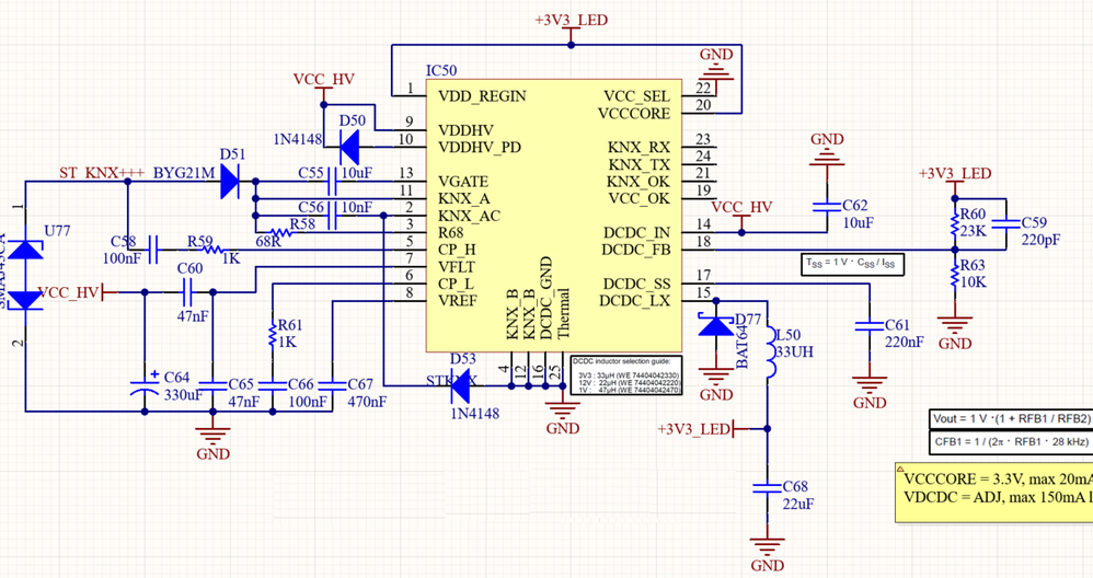

We are using 2 KNX IC on our project. One of them for communication and some LEDs other one (STKNX) just for driving LEDs not for communication. But of course is directly connected to KNX_BUS line.
When we applied Surge test , TVS couldn't protect the device.
I found some solutions but of course is effects other part of design.
TVS is 36V bidrectional.

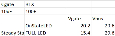

If I choose 100R for 68R connected to pin3 R68 which is transmitter pin, everthing is fine. Passing the test. KNX timing is also good. However, Voltage on VDDHV is lower as excepted, and LEDs are flickering (blinking).
1- How can i juice more power from STKNX?
2- Is this a big problem when i choose 100R instead of 68R, because we are not using STKNX as communication IC.

The schematics would be also useful.
thanks for quick reply,
As you can see we used u77 TVS for protection, 40V was not enough so i changed with 36V for better protection/performans  which is effect the results. But i couldn't solve the R68 burned down problem and same as STKNX burned results. TVS is good condition after test.

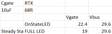

Here is the configuration and Voltage results on some pins. It's while the supply voltage is around 30V, but when we supply ST_KNX+++ (Bus voltage) with 25V, the problem occurs, even if only 4LED is open. Each LED consumes 2mA.
12LED always on (onstate LED condition) , And Additional 12LED (means FULL LED) you can see the difference on Vgate voltage.

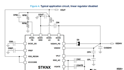

I can see that you have disabled VCCCIRE (connected to VDD_REGIN).. In this case, it should not be connected to +3V3_LED as you did.
The DCDC regulator can provide 150mA at 1V, but its current capability decreases with the voltage. At 3.3V, its current capability will be around 45mA.

in AN5274 page38 (power conversion table) I found this table. It says linear reg disabled (see figure 4 from datasheet) and system can juice 100mA from 3v3. Am i missing something? Also , this is not my priority problem i can fix this with change the resistors and consuming situation. However, I am waiting an answer for this issue also for future usage.
