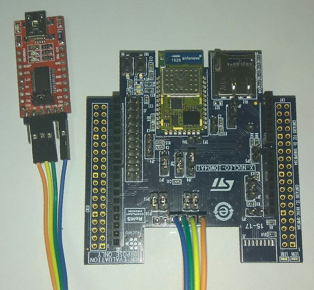

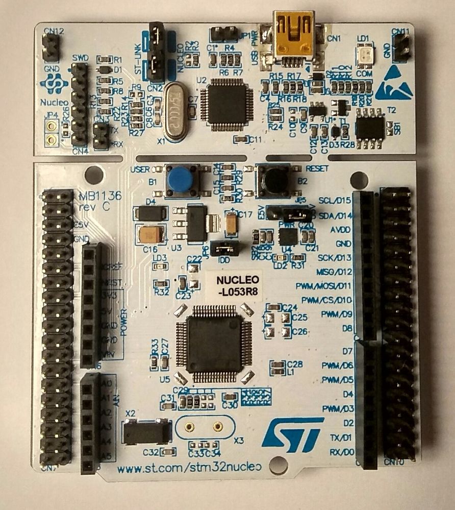

I would like to ask what i'm doing wrong in activating the miniAP with my SPWF04SA. I've read SPWF04SA's datasheet, UM2114, AN4964 and most of ''WiFi Training Hands on SPWF04SA module'' pdf. I have 2-3 modules IDW04A1 and a couple NUCLEO-L053R8 boards. In the beginning i just grabbed a USB to Serial converter (FTDI) and used it to communicate with the IDW04A1 module. After communication was OK, i downloaded ''Flash Loader Demonstrator'' version 2.8 and updated via UART SPWF04SA's firmware. The firmware installed is ''SPWF04S-171117-0328fe3-Release.hex''. In the STSW_WIFI004 folder i saw ''SPWF04S-171117-0328fe3-Full.hex'' file. Is this file the same as ''SPWF04S-171117-0328fe3-Release.hex'' ?? (Anyway i haven't tried this one yet).

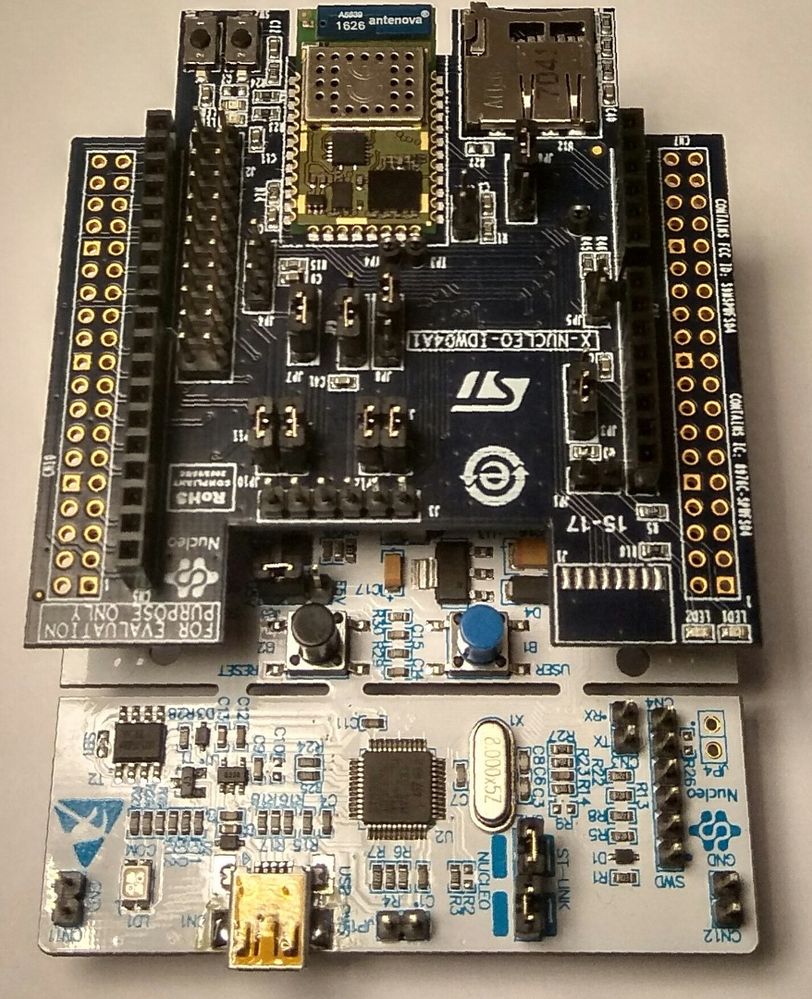

Next i tried some basic commands and some python scripting with AT commands and usb2serial converter setup and everything worked. But when i tried to setup a miniAP, it didn't work out at all. After many tries, resets, and factory default resets I hooked up IDW04A1 on NUCLEO-L053R8 board and miniAP mode worked with first try. After 10 minutes of celebrating of my success i decided to switch again to my humble usb2serial converter. The module responded that it had started the miniAP but my smartphone and laptop weren't able to find my miniAP. I would like to mention also that i have used the module in 9600 and in 115200 baud rates. I have attached photos with the setups that i have used. And the code for setting the miniAP which was the same for every setup that I've used.

Posted on December 18, 2017 at 12:23
The statement 'your system is running low on memory' must be read 'your system is running low on system RAM memory' (the one shown by free_heap status var; min_heap show the absolute min reached by system RAM memory)
I suggested to decrease the amount of ramdisk_memsize and python_memsize because both of them are allocated in system RAM.
ram disk (disk '3' or 'D') size is defined by ramdisk_memsize cfg var, and consume about twice that value from system RAM: if your application can work with a smaller ramdisk then you can set ramdisk_memsize to a smaller value (0 disable the ramdisk at all, 2 is the suggested minimum when the network scan is performed from python).
The same way, when uPython is enabled an amount equal to python_memsize is allocated from system RAM at boot time. This memory space is used for uPython stack, application and structure, while the memory used by TCP/IP stack is still allocated in system RAM even when python sockets/wsocket/mqtt/http modules are used. The free/used python memory can be displayed by specific python functions (i.e. gc.mem_free, gc.mem_alloc): you can reduce python_memsize accordingly and free system RAM resources.
In your case AT+S.FSL show only file with 'I' prefix. Those files are stored in the Application Flash disk and do not consume system RAM.
Setting ramdisk_memsize=12 and python_memsize=32 should allow running Open MiniAP: try keeping SW2 pressed while resetting IDW04A1 to boot SPWF04 in Open MiniAP and verify the configuration is ok (+WIND:26:Started AP:iwm-BD-D1-7A should be displayed for your IDW04A1).
