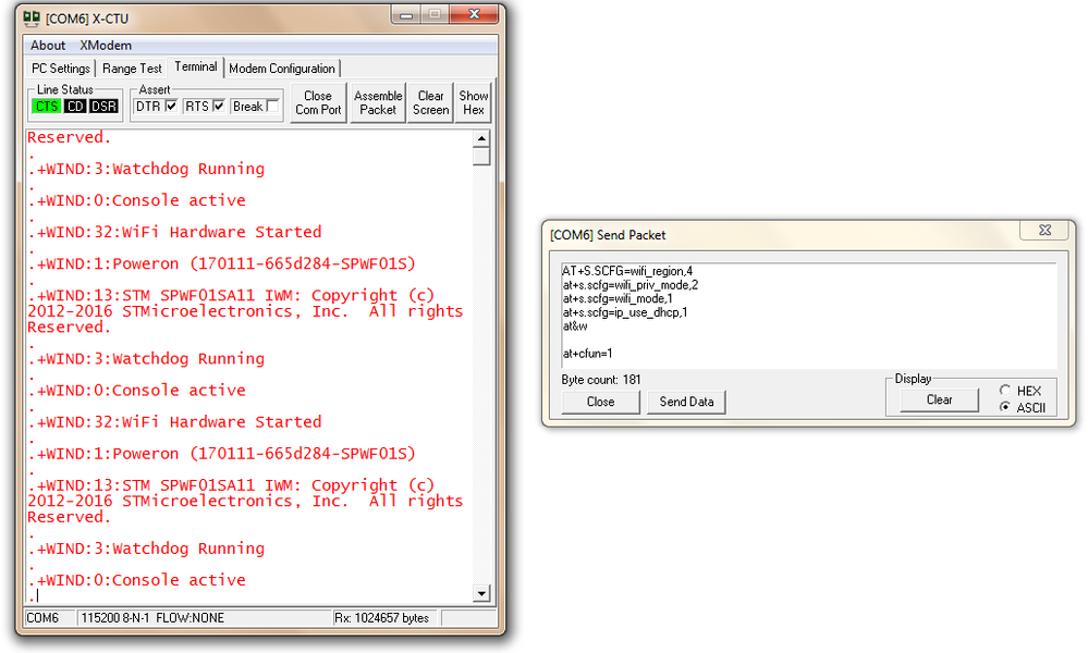

PRATHAP KS
Posted on November 22, 2017 at 12:02
Hi all,
I am facing similar problem.i have updated the firmware to 3.5.3.Still the WiFi module is not able assign IP address.and restarting again
Posted on November 22, 2017 at 16:45
Did you call AT+S.WIFI=0 before AT&W? Try to enable the radio again (AT+S.WIFI=1) before AT&W.
Please dump AT&V and AT+S.STS here (module seems in IDLE mode).
