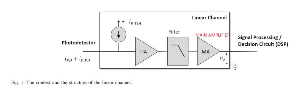

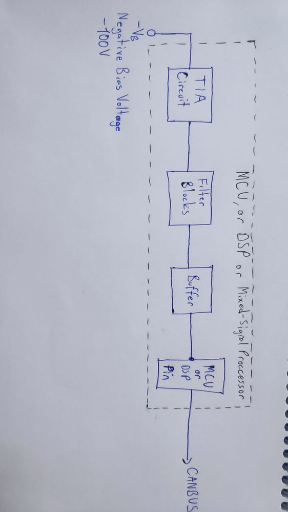

We want to make a system as seen in the photos. But we couldn't find any IC that contains all these (TIA, Filter, Buffer).
0693W00000HpEMBQA3.jpg0693W00000HpEMVQA3.jpgIn the last case;
  • Is there a DSP or MCU that will meet the specifications I wrote above? What are your suggestions?
  • We considered using the MSP430F2311 processor. But would this processor speed be enough for us to detect signals that are below 10ns?
  • It is written that the TIA gain bandwidth in MSP430F2311 is between 1.4 MHz and 4 MHz.In the Stm32g series, the GBW value is between 7-13 MHz. In this case; is TIA enough for us to detect pulses smaller than 10ns? Or is bandwidth important here?
  • If the bandwidth is important here and it is not enough, can we solve it with a timer, interrupt-like hardware in the MCU? If it is not enough; How do we calculate this bandwidth (gain bandwidht)? How should it be determined?
