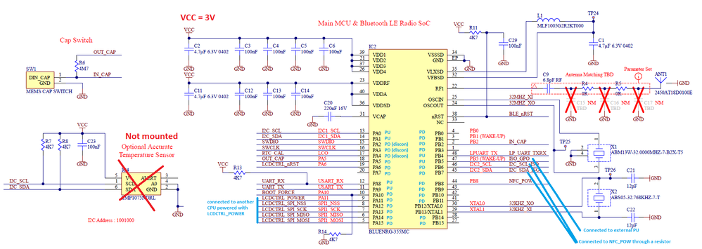

I have a high power consumption during deepstop. The goal is less than 5µA (announced less than 1 in the datasheet).
I removed every other chips on my custom board to found the solution. It's a small board.
When I enter in deepstop mode (without RTC, without any wake-up to test), the current starts at 2-3µA and slowly increases to +-50µA in around 20 seconds. Then the current is stable. We think that it's related with the temperature, if the board is "hot", the starting current is higher.
If I freeze the board, the current change (increase or decrease, it's "random").
I setup PWRC_PUCRx and PWRC_PDCRx according to my board.
Do you know where this issue could come from?
Thank you

    • Leakage problem could be related to PA7 / PB0 / PB1 / PB3 / PB9 / PB10 / PB11 / PB14 / PB15 that are configured as analog No pull while they are not used. If IOs are not used, you should not initialized them so that the pull used will be the one defined with LL_PWR_Enable. Please try not to initialize those IOs as analog if not used.
    Again the problem you faced is typical of an IO set as input and no pull is present.
    • I am not sure to get why you are initiliazing IOs used as UART,SP�?, I2C etc as GPIO input with pull up/down. I guess they are programmed in other place with proper alternate function.

    From description, really seems no pull are programmed during sleep mode.
    Such slow increasing leakage would typically appear if an IO is set as input, physically floating and no pull are programmed.
    Please ensure correct pull are set during sleep mode.
    In BlueNRG-LP SDK code examples, function BSP_IO_Init() is used to configure all IOs in sleep for optimal power consumption with our STEVAL-IDB011 eval board. It can be reused and adapt for custom PCB.

    Could you maybe share your entire IO configuration (not only PWR register) and schematics.
    Attached is short doc that may help you regrading power consumption with BlueNRG-LP.
    Regards
    Laurent
    jbie
    jbieAuthor
    August 22, 2022
    Thank I didn't have this doc. I already implemented everything except LSE driving.
    during my test, UART and debugger are disconnected.
    Part of the schematic that I can share:
    IO init:

    It's working with the first remark, thank you ! I does not know that "normal state" init override "sleep state" init.
