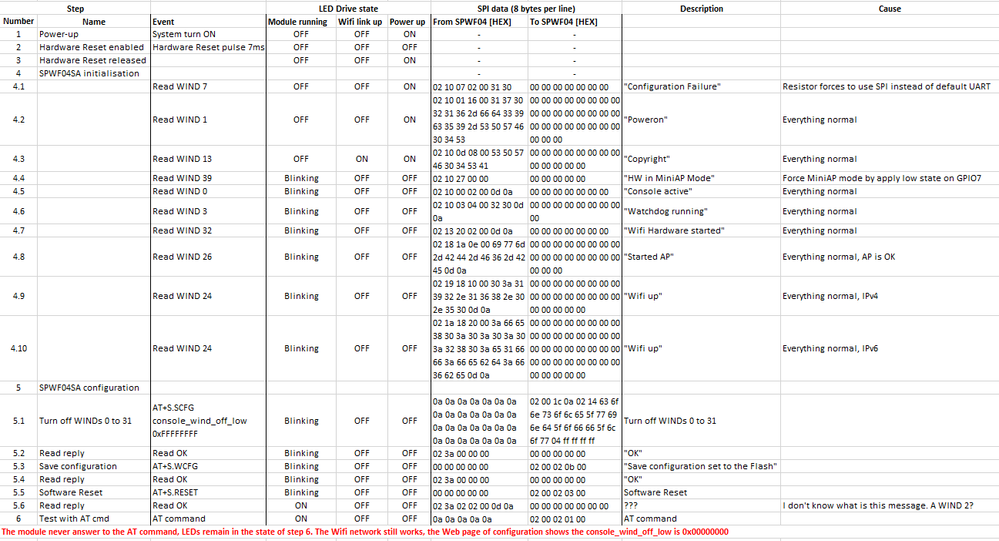

Okay, I see how I am supposed to disable the WIND notifications, but the device does not apply the new config.
I tried with the first 32 WINDS:
1) AT+S.SCFG with 'console_wind_off_low' 0xFFFFFFFF
2)
AT+S.WCFG
3) AT+S.RESET
Then the module doesn't interact anymore with the host. The LED of GPIO 10 (module running) stop blinking and stay ON.
Should I do something more after the WIND 2 'Reset' notification?

Since you masked 0 to 31 WINDs, you should receive the only WIND:32
After reset, blinking LED starts blinking (and then it stops), or never starts blinking? In the first case, console LED should be on (before WIND:0, even if masked) and than off (at WIND:0 time); in the second case, console LED never goes high. In the first case module will reboot because of watchdog; in the second case module never starts. In both cases, module stops because SPI master is not giving the clock after an nHostIRQ interrupt, or SPI master gives less clocks than required by module's SPI header.
Note: if you need to perform a factory reset (and restore wind_off_low value), you can do via HW. Put GPIO0 high at startup.
Posted on November 28, 2017 at 15:56
Don't worry for the micro, I got it
I made you the step-by-step initialisation as implemented in my program, including LEDs' states:
The SPWF04SA no longer assert the nHostIRQ line. I tried with different value for console_wind_off_low such 0x20000000 but it is still the same behavior.
It seems, it is a problem with the Reset command. Do I use it correctly?
